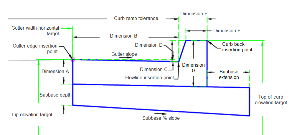

The curb and gutter links are inserted based on the Input Parameter dimensions Dimension A - Dimension F. All dimensions must be positive, non-zero values. If a non-zero subbase depth is given, the subbase layer is inserted to the back of curb, and continues for the Subbase Extension width. The subbase layer closes to the bottom-back-of-curb, as shown in the diagram.
If the insertion point is other than back of curb, then the curb height is adjusted by the Top Of Curb Target. The adjustment may not exceed the top of curb height or reduce the curb face below zero. If the top of curb elevation is exceeded the full face of the curb is built. If the top of curb elevation is less than zero, then a zero value is used.
If the insertion point is other than GutterEdge then the gutter width and slope is adjusted if the targets for the gutter edge are present. The gutter slope and elevation targets may need to be non-standard to meet accessibility requirements.
The subassembly builds the shape for a curb and gutter, with the attachment point either at (a) inside edge of the gutter (or lip), or (b) the back of the curb, or (c) the flowline. The face of the curb is given a small, constant width to make it non-vertical.

Coding Diagram
