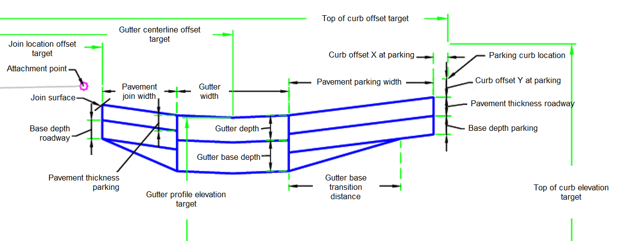

The ParkingAdjacentToRoad subassembly builds a parking area adjacent to an existing roadway. The parking includes a paved area of the existing roadway, a gutter, and a parking pavement. The parking pavement ties into a proposed curb elevation and top of curb location.
The attachment point is at a point at the center of the roadway. This component can be attached to either the left or right side.

The initial reference point is set at the attachment point. The top of curb profile and offset values are found to determine the location of the outer edge of the parking pavement. The join location is determined from the join location target. The join elevation is found based on the join location and the join surface target at this point. The gutter location and gutter elevation are determined from the set targets. The gutter geometry is then built based on the input parameters. The pavement join geometry is built from the target join elevations and input parameters. Then the parking pavement is built using the target values and input parameters.

Coding Diagram
