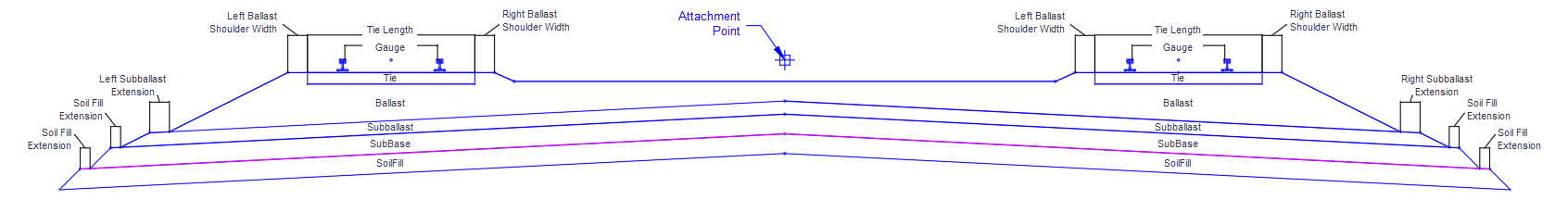

By default, the attachment point is at the centerline between the rails of the left track. The tracks can be moved relative to this point using the subassembly parameters.
Input Parameters

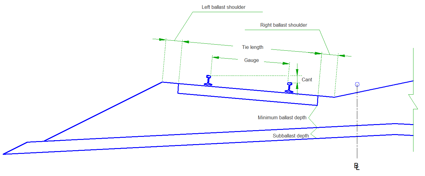

Measure Cant At
Determines whether the elevation difference between rails takes place between the gauge line (face) of each rail or CL of each rail.
Selection List:
  • Gauge Line to Gauge Line
  • CL Rail to CL Rail
CL Rail to CL Rail
Default Cant
The default elevation difference between rails. The value is positive when the right rail is higher than the left and negative when the right rail is lower than the left. This value is applied in layout mode and is helpful for observing how the subassembly reacts to different cant values. This value is overridden by cant when it is present via the baseline alignment.

Tie Length
Length of the tie (also known as sleeper).
Numeric, non-negative
8.5'
2.59 m
Tie Depth
Depth of tie
7"
178 mm
Minimum Ballast Depth
The minimum vertical distance between the bottom of the tie and the top of the Subballast. The location of this minimum distance changes at different stages in cant. See "Behavior" below.
12"
305 mm
Ballast Shoulder Width (Left and Right)
The distance from the end of the tie to the beginning of the ballast side slope.
1 ft
0.30 m
Ballast Side Slope (Left and Right)
The slope of the side of the ballast material. The slope of the top of the ballast material matches the slope of the tie that results from cant.
Slope, non-negative
2:1

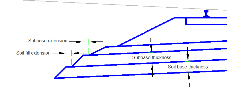

Sub_Base Slope
The slope of the side of the SubBase material.
Slope, non-negative
1:1
Sub_Base Extension
The distance from the toe of the subballast material to the beginning of the side slope of the SubBase material
0.5'
150 mm
Sub_Base Depth
The depth of the SubBase material
12"
300 mm
Omit SubBase
Prevents the SubBase points, links, and shapes from being drawn. If the Omit Ballast, Omit Subballast, or Omit Soil Fill option is set to Yes then the SubBase is not drawn regardless of this setting.
Yes/No
No
Soil Fill Slope
The slope of the side of the Soil Fill material.
Slope, non-negative
1:1
Soil Fill Depth
The depth of the Soil Fill material
12"
300 mm
Soil Fill Extension
The distance from the toe of the soil fill material to the beginning of the side slope of the Subballast material.
0.5'
150 mm

Behavior
When no targets are applied, the location of either track is determined by the Left Track Offset, Right Track Offset, Left Track Elevation Difference, and Right Track Elevation Difference. These values locate the center points between the tracks. By default, the Left Track Offset is zero placing the centerline of the left track at the baseline. When target alignments and profiles are applied, these values are overridden. When using target alignments for the track centerlines, the tracks always remain perpendicular to the baseline, not the target alignment. When the target alignments are not parallel to the baseline alignment, distortion will occur and the track dimensions will not be accurately represented.
Important: The RailDoubleTrackCANT subassembly calculates cant from the single center alignment and not from targets. True offset tracks may have different curve geometry and design speeds that the centerline calculation cannot accommodate. This subassembly is for primary design. For accurate cant calculation, separate baselines modeling the Left and Right Multi Track subassemblies should be used.
When you apply rail cant information to the alignment baseline, the rails rotate accordingly. The point about which they rotate depends on the Pivot Method setting contained in the cant information for the alignment. If you set a Pivot Method to Low Side Rail, then the rail on the inside of the curve is held at track elevation and the elevation of the outside rail is adjusted an amount equal to the cant value.
If you set the Pivot Method to High Side Rail, then the rail on the outside of the curve is held at track elevation and the elevation of the inside rail is adjusted an amount equal to the cant value.
If you set the Pivot Method to Center Baseline, then both rails are adjusted an amount equal to half the cant value, the outside rail upward and inside rail downward.
The Minimum Ballast Depth value applies at the location of the minimum clearance between the tie and subballast. The Subballast Top Slope parameter independently controls the subballast top slope . The Baseline to Subballast Crown parameter controls the location of the subballast crown.

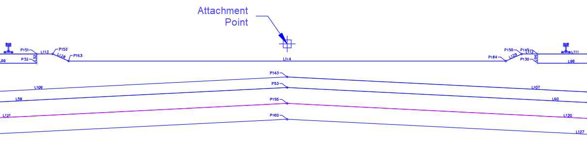

Point, Link, and Shape Codes
The following table lists the point, link, and shape codes for this subassembly that have codes assigned to them. Point, link, or shape codes for this subassembly that do not have codes assigned are not included in this table.
Point, Link, or Shape
Code
Description
L32 Ballast,Ballast_Between_Ties Ballast material in open space between ties. Can also be used when ties are omitted.
L116-L119 Top, SoilFill SoilFill
L120-L121 SoilFill, SubBase" SoilFill
L122-L125 Top, SubBase SubBase
L126-L127 SubBase, Datum SubBase
S1, S2 Rail Rails
S3 Tie Tie
S4 Ballast Ballast
S5 Subballast Subballast
S6 SubBase SubBase
S7 SoilFill SoilFill
Coding Diagrams
