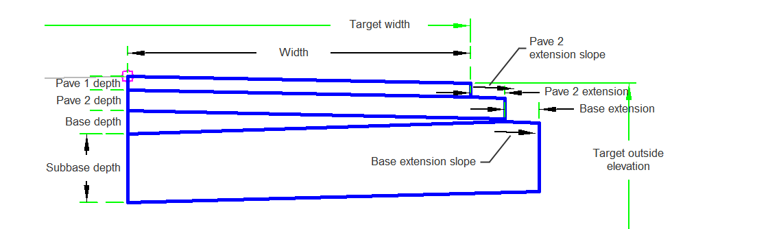

The ShoulderVariesExtensions subassembly has a base and subbase that extends past the rest of the pavement layers.
The attachment point is at the inside edge of the paved shoulder, which is typically at the outside edge-of-traveled way.

Behavior
The finish grade of the shoulder is inserted for the given Shoulder Width and Default Shoulder Slope outward from the attachment point. The Pave2 points and links are then drawn. A Pave2 extension is provided using the input parameters. The Base points and links, including extension, are calculated using the input parameters. The Subbase points, links, and shape, including extension, are calculated using the input parameters.
Layout Mode Operation
In layout mode the subassembly displays the links comprising the shoulder.
