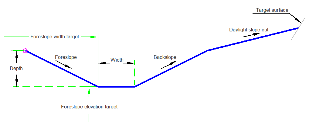

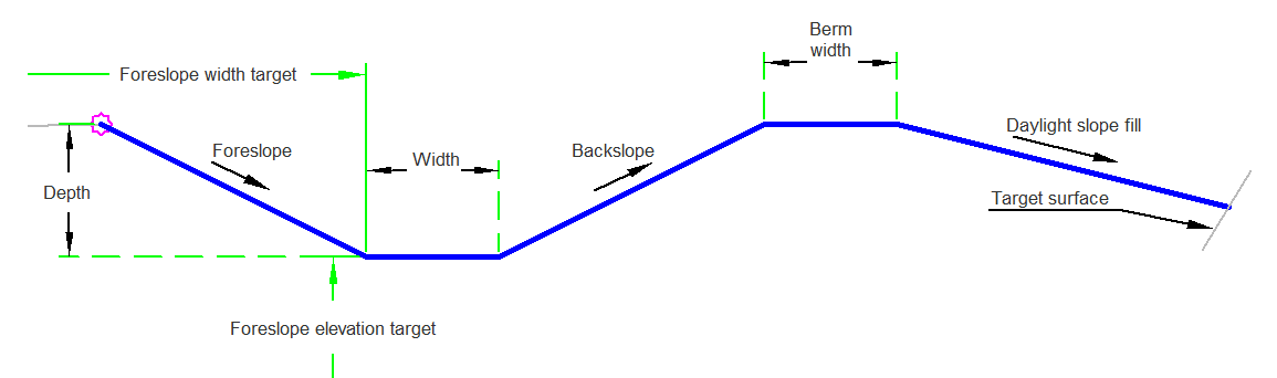

The SlopeDitch subassembly creates a ditch with backslope and foreslopes. In cut, it daylights to the existing ground. In fill, a berm is created and then daylights.
Case Cut:
Case Fill:
The attachment point is the innermost point on the grading links preceding the ditch.

Behavior
The ditch foreslope, bottom, and backslope of the ditch are created. The subassembly is then determined to be in cut or fill at the top of the backslope. If in fill, a berm is created and then daylights. If in cut, the daylight link is created using the daylight slope.
