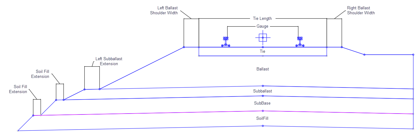

The Left_Hand_Multi_Track subassembly is used for a single railroad that includes sleepers, ballast, subballast, and two additional layers or materials which can be used for Sub Base and Soil Fill material.
The dimensions of the Left_Hand_Multi_Track rails can be edited as well as the dimensions of the material layers.

| Ballast Shoulder Width (Left and Right) | The distance from the end of the tie to the beginning of the ballast side slope. | Numeric, non-negative | 12"
305 mm |
| Ballast Side Slope (Left and Right) | The slope of the side of the ballast material. The slope of the top of the ballast material matches the slope of the tie that results from cant. | Slope, non-negative | 2:1 |
| Subballast Depth | The depth of the subballast material | Numeric, non-negative | 8"
203 mm |
| Subballast Top Slope (Left and Right) | The top slope of the left and right sides of the subballast with the centerline of the subassembly as the hinge point. | Slope, non-negative | 40:1 |
| Subballast Side Slope | The slope of the side of the subballast material. | Slope, non-negative | 2:1 |

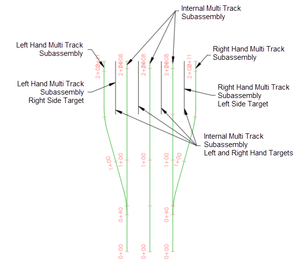

Target Parameters
This section lists the parameters in this subassembly that can be mapped to one or more target objects. For more information, see To Specify Corridor Targets.
Parameter |
Description |
Status |
| RightSideOffset | Right Side Offset | Optional |
| RightSideElevation | Right Side Elevation | Optional |

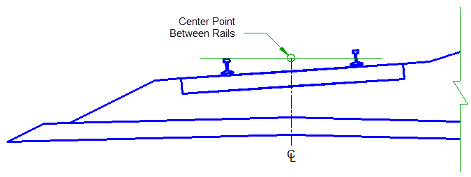

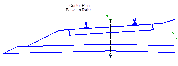

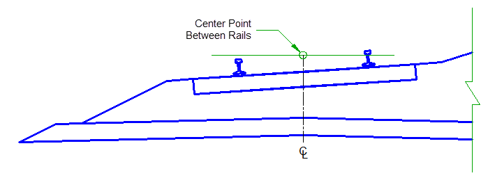

Behavior
If you set the Pivot Method to High Side Rail, then the rail on the outside of the curve is held at track elevation and the elevation of the inside rail is adjusted an amount equal to the cant value.
If you set the Pivot Method to Center Baseline, then both rails are adjusted an amount equal to half the cant value, the outside rail upward and inside rail downward.
The Minimum Ballast Depth value applies at the location of the minimum clearance between the tie and subballast. The Subballast Top Slope parameter independently controls the subballast top slope . The Baseline to Subballast Crown parameter controls the location of the subballast crown.

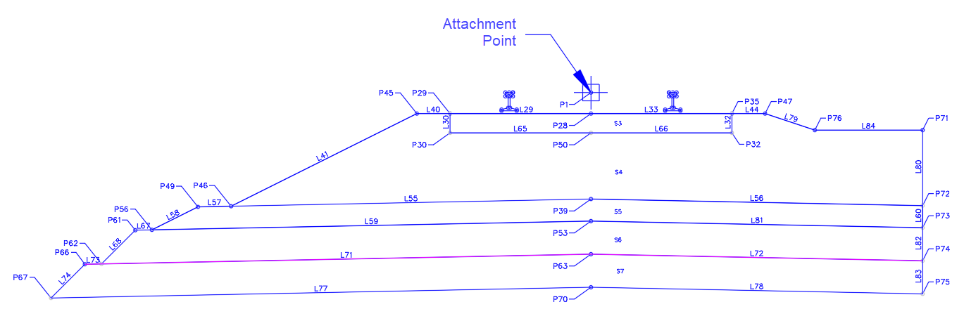

Point, Link, and Shape Codes
The following table lists the point, link, and shape codes for this subassembly that have codes assigned to them. Point, link, or shape codes for this subassembly that do not have codes assigned are not included in this table.
Point, Link, or Shape |
Code |
Description |
| P1, P4-P21 | Rail | Rail |
| P2 | Cl_Rail | Centerline of Rail |
| P3 | Gauge_Line,Rail | Gauge line (inside edge of top of rail) |
| P28-P32, P60 | Tie | Tie |
| P45, P54-P55, P47, P71-P72 | Ballast | Ballast |
| P50, P53, P73 | Subballast | Subballast |
| P63, P65, P74 | SubBase | SubBase |
| P68-P70, P75 | SoilFill | SoilFill |
| L1, L2 | Top_Rail, Rail | Top of rail |
| L3-L28 | Rail | Rail |
| L29-L33, L65-66 | Tie | Tie |
| L40-L41, L44, L55-L56, L79, L88 | Ballast | Ballast |
| L57, L60-L62, L80 | Subballast | Subballast |
| L70-L72, L81 | SubBase | SubBase |
| L76-L78, L82 | SoilFill | SoilFill |
| S1, S2 | Rail | Rails |
| S3 | Tie | Tie |
| S4 | Ballast | Ballast |
| S5 | Subballast | Subballast |
| S6 | SubBase | SubBase |
| S7 | SoilFill | SoilFill |
