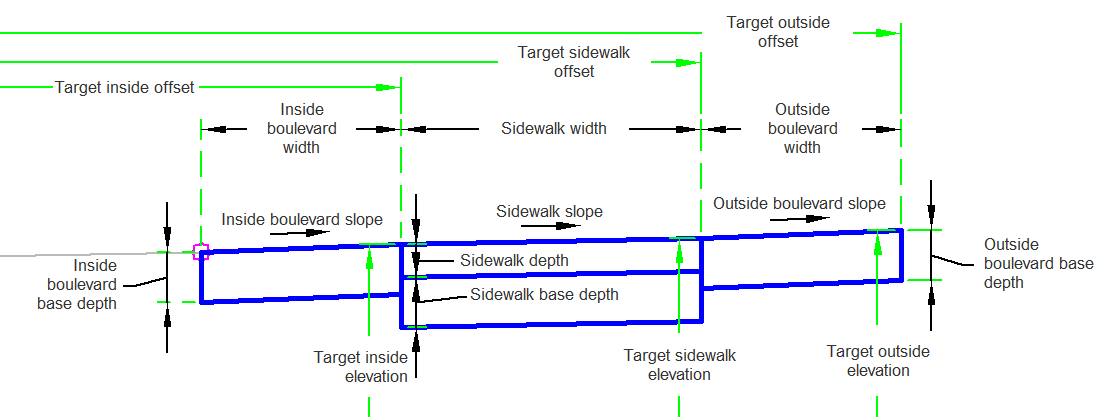

The SidewalkSlopesAndBase subassembly creates links for a concrete sidewalk with inside and outside boulevards.
The attachment point is at the inside edge of the inside boulevard. The SidewalkSlopesAndBase subassembly is typically attached to a back-of-curb or edge of pavement.

Behavior
The inside grass strip, sidewalk, and outside grass boulevard links are inserted outward from the attachment point at the given slope. The grass strips can be omitted by specifying a zero-width.
Optionally, various element widths can be attained by attaching to offset alignments. Also, the cross slopes can be derived by tying into offset profiles.

Point, Link, and Shape Codes
The following table lists the point, link, and shape codes for this subassembly that have codes assigned to them. Point, link, or shape codes for this subassembly that do not have codes assigned are not included in this table.
Point, Link, or Shape |
Code |
Description |
| P1 | Top | |
| P2 | Sidewalk_In, Top | Inside Sidewalk |
| P3 | Sidewalk_Out, Top | Outside Sidewalk |
| P4 | OutsidePointCode, Top | Outside Point Code |
| P5 | Sidewalk_Datum, BottomConcrete | Sidewalk Datum, Bottom of Concrete |
| P6 | Sidewalk, BottomConcrete | Bottom of Concrete |
| P7, P8 | Sidewalk_Base | Sidewalk Base |
| P9, P10 | InsideBaseDepth | Inside Base Depth |
| P11, P12 | OutsideBaseDepth | Outside Base Depth |
| L1 | Top | |
| L2 | Top, Sidewalk | |
| L3 | Top | |
| L5, L6 | Sidewalk, Datum | |
| L7 | Sidewalk | |
| L8, L10, L13, L14 | Base, Datum | |
| L9 | Sidewalk_Base | Sidewalk Base |
| L11 | InsideBaseDepth | Inside Base Depth |
| L12 | InsideBase, Datum | Inside Base |
| L15 | OutsideBaseWidth | Outside Base Width |
| S1 | Sidewalk | |
| S2, S3 | BasePlanter | Base Planter |
| S4 | Base |
Coding Diagram
