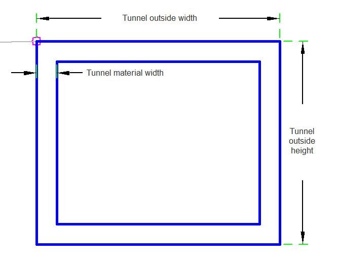

The SimpleTunnel subassembly is for a simple tunnel, or box culvert. It uses the height, width, and material thickness that you input.
The attachment point is the uppermost point on the links preceding the tunnel.
Input Parameters
Parameter |
Description |
Type |
Default |
| Tunnel Material Width | Width of the walls, floor, and roof of the tunnel. | Numeric, positive |
1 ft 0.3 m |
| Tunnel Outside Height | Height of the outside of the tunnel. | Numeric, positive |
10 ft 3 m |
| Tunnel Outside Width | Width of the outside of the tunnel. | Numeric, positive |
12 ft 3.5 m |
Target Parameters
None.
Runtime Logical Assignments
None.
Output Parameters
None.
Behavior
The points, links, and shapes are created using the input parameters.
Layout Mode Operation
In layout mode the subassembly displays the links comprising the tunnel.
