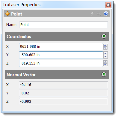

Points define the path that the laser follows and are associated with curves. To add a point, right-click on a curve in the tree and select Add Point.
To define the point values, right click on the point and select Edit Properties.
Enter your settings and click Apply. Refer to the table below for property details.
Name A unique name to help you easily identify this point in the layout.
Coordinates X, Y, Z The X (horizontal), Y (vertical), Z (depth) coordinates for the point.
Normal Vector X, Y, Z This lists the I, J, and K coordinates for the normal vector of the point. A normal vector is another point location that signifies a direction away from the tool or surface that the laser projection will display upon.
