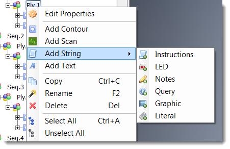

Add Strings
A laser string is any information that you want to include in a laser projection file, but it should not be used to control laser projection. Examples include instructions or notes.
Instructions Instructions associated with this projection. Instructions require an acknowledgment that they have been read.
LED Pass messages to an LED crawl board; for example, ply name or material
Notes Free-form text to include with the laser file.
Query Create "yes" or "no" questions; responses are recorded in reports
Graphic Display graphic on a flat screen while running laser projection
Literal Add comment information to keep with the file, but to be ignored by the laser such as time/date stamp or author information
