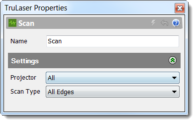

Add Scan Properties
Scans provide a way to locate real world features on your tool. For example, a raw edge will attempt to detect the edge of your tool that you have called out as a scan. This detection can be used for targeting purposes or for quality assurance inspection.
Note: Some brands do not support scans.
Scans can be added at the group level by right-clicking on a group name and selecting Add Scan.
To define the scan values, right-click on the scan and select Edit Properties.
Enter your settings and click Apply. Refer to the table below for property details.
| Name | The scan name |
| Projector | The projector associated with the scan |
| Scan Type | The nature of scan such as raw edge, retro target, edge, and other options |
