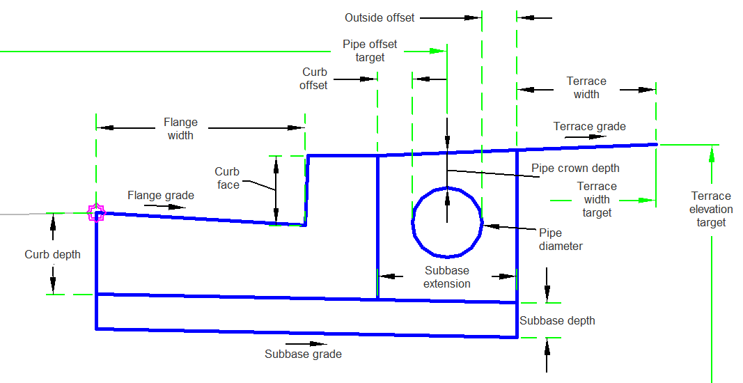

Behavior
The subassembly builds a shape for a simple curb and gutter, with the attachment point at the flange of the gutter. A pipe is then placed behind the curb with bedding material. A terrace is then placed behind the pipe bedding material.
Layout Mode Operation
In layout mode, this subassembly displays the curb-and-gutter, pipe, and terrace components based on the input parameters given.

Coding Diagram
