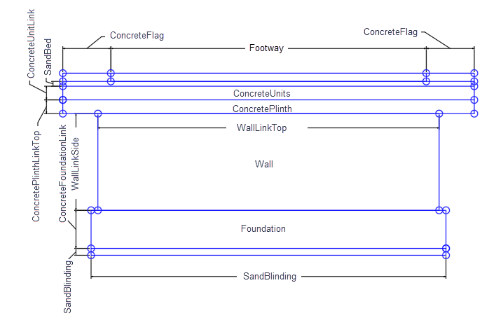

The Dual_RailPlatform subassembly includes common layers for dual rail platforms such as walls, concrete plinth, footway, sand bed, and foundation.

This subassembly provides a rail platform that ties between two different rail alignments for a variable width, and a profile for a variable slope. Place the platform subassembly insertion point on the centerline alignment and profile of the primary rail and adjust the behavior by setting the input parameters and the Secondary Rail target parameters listed above. Additional target parameters are provided to control the platform offset and elevation, overriding the platform input parameters.
Layout Mode Operation
In layout mode, this subassembly draws the dual rail platform.
Point, Link, and Shape Codes
The following table lists the point, link, and shape codes for this subassembly that have codes assigned to them. Point, link, or shape codes for this subassembly that do not have codes assigned are not included in this table.
Point, Link, or Shape |
Code |
Description |
P1 | WallBottomLeft | Wall Bottom Left |
P2 | WallTopLeft | Wall Top Left |
P3 | WallTopRight | Wall Top Right |
P4 | WallBottomRight | Wall Bottom Right |
P5 | PlinthBottomLeft | Plinth Bottom Left |
P6 | PlinthTopLeft | Plinth Top Left |
P7 | PlinthTopRight | Plinth Top Right |
P8 | ConcreteUnitsTopLeft | Concrete Units Top Left |
P9 | ConcreteUnitsTopRight | Concrete Units Top Right |
P10 | SandBedTopLeft | Sand Bed Top Left |
P11 | SandBedTopRight | Sand Bed Top Right |
P12-P13 | PlatformEdge | Platform Edge |
P14 | PlatformEdgeBottom | Platform Edge Bottom |
P15 | Top, FootwayRightEdge | Footway Right Edge |
P16 | FoundationRightEdge | Foundation Right Edge |
P17 | FoundationBottomRight | Foundation Bottom Right |
P18 | FoundationBottomLeft | Foundation Bottom Left |
P19 | FoundationEdgeLeft | Foundation Edge Left |
P20 | PlinthBottomRight | Plinth Bottom Right |
P21 | SandBlindingRightTop | Sand Blinding Right Top |
P22 | SandBlindingRightBottom | Sand Blinding Right Bottom |
P23 | SandBlindingLeftBottom | Sand Blinding Left Bottom |
P24 | FoundationBackTopLeft | Foundation Back Top Left |
P25 | FoundationBackTopRight | Foundation Back Top Right |
L1 | WallLinkSide | Wall Link Side |
L2 | WallLinkTop | Wall Link Top |
L3 | WallLinkSide | Wall Link Side |
L4 | WallLinkBottom | Wall Link Bottom |
L5 | ConcretePlinthLink | Concrete Plinth Link |
L6 | ConcretePlinthLinkTop | Concrete Plinth Link Top |
L7 | ConcretePlinthLink | Concrete Plinth Link |
L8 | ConcretePlinthLinkBottom | Concrete Plinth Link Bottom |
L9 | ConcreteUnitLink | Concrete Unit Link |
L10 | ConcreteUnitLinkTop | Concrete Unit Link Top |
L11 | ConcreteUnitLink | Concrete Unit Link |
L12 | ConcreteUnitLinkBottom | Concrete Unit Link Bottom |
L13 | SandBedBottomLeft | Sand Bed Bottom Left |
L14 | SandBedLinkTop | Sand Bed Link Top |
L15 | SandBedBottomRight | Sand Bed Bottom Right |
L16 | SandBedLinkBottom | Sand Bed Link Bottom |
L17 | ConcreteFlagLink | Concrete Flag Link |
L18 | ConcreteFlagLink, Top | ConcreteFlagLink, Top |
L19-L20 | ConcreteFlagLink | Concrete Flag Link |
L21 | Footway, Top | Footway |
L22 | FootwayLink | Footway Link |
L23 | FootwayLinkBottom | Footway Link Bottom |
L24 | FootwayLink | Footway Link |
L25-L28 | FoundationLink | Foundation Link |
L29 | SandBlindingTop | Sand Blinding Top |
L30, L32 | SandBlinding | Sand Blinding |
L31 | SandBlindingBottom | Sand Blinding Bottom |
L33, L35 | FoundationBack | Foundation Back |
L34 | FoundationBackTop | Foundation Back Top |
L36 | FoundationBackBottom | Foundation Back Bottom |
S1 | Wall | Wall |
S2 | ConcretePlinth | Concrete Plinth |
S3 | ConcreteUnits | Concrete Units |
S4 | SandBed | Sand Bed |
S5 | ConcreteFlag | Concrete Flag |
S6 | Footway | Footway |
S7 | Foundation | Foundation |
S8 | SandBlinding | Sand Blinding |
