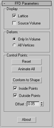

FFD Parameters rollout
Display group
Affects the display of the FFD in the viewports.
- Lattice
- Draws lines connecting the control points to make a grid.
Although the viewports can sometimes become cluttered when these lines are drawn, it helps to visualize the lattice.
- Source Volume
- Displays the control points and lattice in their unmodified state.
When the Lattice selection level is active, this helps to position the source volume.
Tip: To see which points lie in the source volume (and therefore will be deformed), temporarily deactivate the modifier by clicking the light bulb icon in the modifier stack display to turn it off.
Deform group
- Only in Volume (The default.) Deforms vertices that lie inside the source volume.
- All Vertices Deforms all vertices, regardless of whether they lie inside or outside the source volume.
The deformation outside the volume is a continuous extrapolation of the deformation inside the volume. The deformation can be extreme for points far away from the source lattice.
Control Points group
- Reset
Returns all control points to their original positions.
- Animate All
Assigns Point3 controllers to all control points so that they're immediately visible in Track View.
By default the control points of an FFD lattice don't appear in Track View because they don't have controllers assigned to them. But when a control point is animated, a controller is assigned to it and becomes visible in Track View. With Animate All, you can add and delete keys and perform other key operations.
- Conform to Shape
Moves each FFD control point to the intersection of the modified object with a straight line extending between the object's center to the control point's original location, plus an offset distance specified by the Offset spinner.
Note: Conform to Shape works best with regular shapes, such as primitives. It's less effective if the object has degenerate (long, narrow) faces or sharp corners. All the controls are unavailable with shapes, because there are no faces to intersect with. - Inside Points
Only control points inside the object are affected by Conform to Shape.
- Outside Points
Only control points outside the object are affected by Conform to Shape.
- Offset
The distance by which control points affected by Conform to Shape are offset from the object surface.
- About
Displays a dialog with copyright and licensing information.
