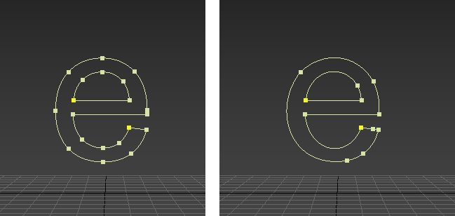

The Optimize Spline modifier reduces the number of knots and adjusts their handles to optimally reproduce the original spline as closely as possible.
A Text spline before (left) and after an optimization of 40%. Note how the curves remain intact even with fewer knots defining them.

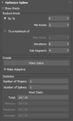

Interface
Optimize Spline rollout
- Show Knots
- Displays knots on the spline.
Reduce Knots group
Sets how the target number of knots should be determined. If there are multiple splines within the shape, the settings are applied to each spline.
- By %
- Sets a reduction in knots by a specified percentage. The maximum is 99%.
- Min Knots
- Sets the minimum number of knots to be retained.
- To a maximum of
- Uses a maximum number of knots as the reduction target rather than a specific percentage.
- Max Knots
- Sets the maximum number of knots to be retained after optimization.
- Iterations
- Sets the number of iterations used to optimize the placement of knots and their tangents. Higher numbers produce better results but take longer to compute.
- Sub Segment
- Sets the number of knots to add between existing knots during optimization. Higher numbers produce better results but take longer to compute.
Create group
- Make Spline button
- Creates a duplicate spline with the final result of the calculation to avoid further computation once the desired result is achieved.
- Make Adaptive
- Enables adaptive interpolation on the created spline.
Statistics group
- Number of Shapes
- Displays the number of shapes in the current selection.
- Number of Splines
- Displays the number of splines in the current selection.
- Knot Stats
- Displays the total, minimum, maximum, and average number of knots.
