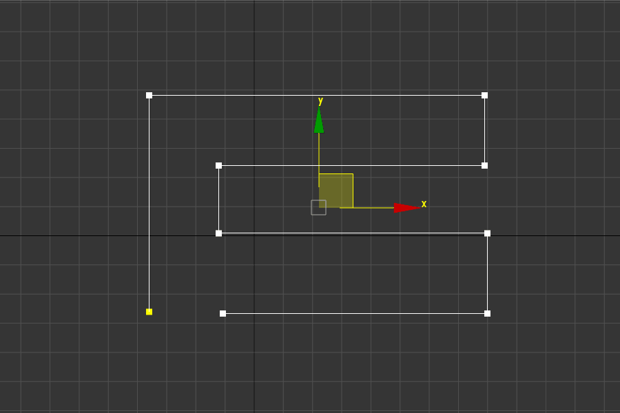

Applies a fillet or chamfer to a spline using knots passed up the modifier stack. The fillet or chamfer output result is then computed based on the incoming and outgoing vectors of a knot point.
Interface
Chamfer rollout
- Show Knots
- Displays knots on the spline.
- Amount
- Sets the width of the chamfer in distance units.
- Depth
- Controls the fixed depth of the chamfer:
- A depth of 1.0 will produce a sharp corner on convex edges.
- A depth of 0.0 will produce a flat result.
- A depth of -0.5 will produce a concave curve along a convex edge.
- Bias
- Biases the chamfer towards or away from the knot.
- Limit Effect
- When enabled, prevents the overshooting of edges by restricting the distance chamfered sub-objects can travel towards each other. When Limit Effect is on, increasing the Amount setting past a certain value (based on existing geometry) has no effect.
- Use Soft Selection
- Uses any selected knots below the stack to influence the chamfer operation. If no knots are selected, all knots are affected.
- Min. Angle
- Sets a minimum angle for applying the chamfer.
- Corner Knots Only
- When enabled, only corner knots are affected by the operation.
