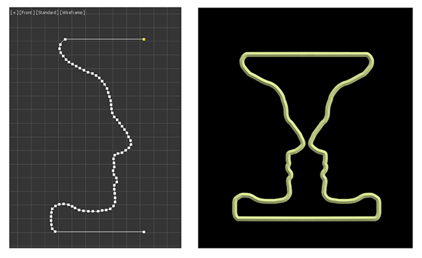

The spline is automatically duplicated along the specified axis.
A Rubin vase created by applying a Spline Mirror modifier onto an editable spline.
