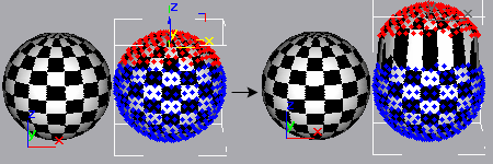

Example: Use the Preserve modifier on a geosphere:

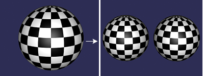

- Create a GeoSphere and use
Shift+Move to make a copy of it. Tip: If you want to see the effect of Preserve on mapping, apply a checker-mapped material to the sphere and display it in the viewports before making the copy. - Convert the copy to an editable mesh.
- At the Vertex sub-object level, select a third of the vertices at the top of the sphere, and move them upward (as seen from the front) about one radius in distance.
Notice the stretched edges between the moved vertices and the remaining vertices.
- While still at the Vertex sub-object level, apply the Preserve modifier.
- Click the Pick Original button, and then select the original (unedited) sphere.
The selected vertices move back toward the sphere in an attempt to maintain the original volume and edge lengths.

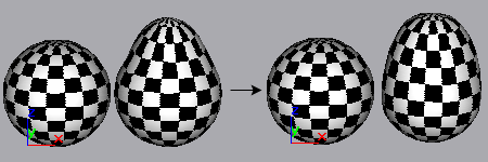

- Turn on Invert Selection.
The selected vertices return to their moved position, and the unselected vertices (the inverted selection) move up toward the selected vertices.
- Turn off Invert Selection and slowly reduce the Iterations to 0.
The object now looks as it did before you applied Preserve.
- Increase Iterations to the default 25, and then increase it to approximately 75.
The object is now almost completely spherical again.
- Set Iterations back to 25, and then try different Edge Lengths, Face Angles, and Volume settings. (You can restore the defaults by settings Edge Lengths to 1.0, and Face Angles and Volume to 0.3.
