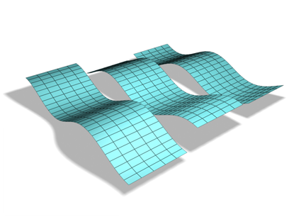

An object with the Wave modifier applied. Amplitude 1 and 2 can be changed, creating different profiles.

Select an object and apply the Wave modifier. Tip: To see the effect clearly, apply Wave to a broad, flat object that has many segments.- Set one or both values for amplitude, or the vertical height of the wave in current units.
Amplitude 1 produces a sine wave from one edge to the other, while Amplitude 2 creates a wave between the opposite edges. Switching a value from positive to negative reverses the position of peaks and troughs.
- Set the length of the wave and the distance in current units between crests of both waves.
The greater the length, the smoother and more shallow the wave for a given amplitude.
