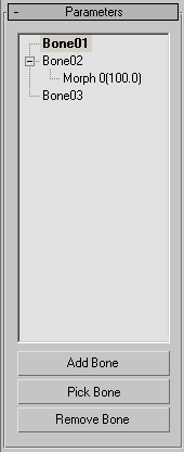

Parameters rollout
- [list window]
Lists all attached bones and their morphs in a hierarchical view. You can expand or contract a bone's morph listing by clicking the + or - box next to its name in the list. The number in parentheses next to the morph name shows its relative influence as a percentage at the current frame.
Highlighting a bone in the list highlights the bone in the viewports as a yellow line, and lets you create a morph for it. Alternatively, you can select the bone in the viewport while the modifier's Points sub-object level is active by clicking the orange line through its center.
Highlighting a morph in the list lets you edit the morph. To change the morph's name, edit the Local Properties rollout
Morph Name field. - Add Bone
Click to add one or more bones from the Select Bones dialog.
Tip: To keep things simple, add only bones that will drive morphs. There's no point in adding any other bones. - Pick Bone
Lets you add bones by selecting them in a viewport.
Click Pick Bone, and then select bones in any viewport. While Pick Bone is active, the cursor resembles a cross with the words ADD BONE attached. To exit Pick Bone mode, right-click the active viewport or click Pick Bone again.
- Remove Bone
Removes a bone and its morphs from the list. Click a bone name in the list, and then click Remove.
If a morph name is highlighted when you click Remove, its bone is removed. To remove the morph only, highlight it and then click Local Properties rollout
Delete Morph.

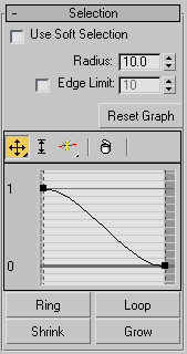

Selection rollout
- Use Soft Selection
Enables soft selection for editing vertices.
Soft Selection in Skin Morph works much like Soft Selection in other parts of 3ds Max, except that instead of Pinch and Bubble settings you can adjust the graph shape directly, and it uses a Radius setting instead of Falloff to determine the extent of the soft-selection area.
- Radius
Determines the extent of the soft-selection area in system units.
- Edge Limit
When on, Skin Morph uses the Edge Limit numeric setting to determine the extent of the soft-selection area in terms of the number of edges from the selected vertex or vertices.
- Reset Graph
Sets the soft-selection graph to default values. Use this if a vertex or handle is no longer visible and thus cannot be manipulated.
- [graph]
Skin Morph provides a small, full-functioned curve graph for editing soft-selection characteristics globally; it works much like other such graphs in 3ds Max, such as the Curve Editor. The toolbar above the graph offers functions for moving and scaling points on the graph, as well as inserting new ones. The same functions are available by right-clicking the graph: If you right-click a graph point, you can set it to Corner or one of two different Bezier types. If you select a Bezier point, you can reshape the curve by moving its handles.
- Ring
Expands a vertex selection by first converting the selection to an edge selection, selecting all edges parallel to the selected edges, and then converting the new edge selection back to a vertex selection. Use of Ring requires that a qualifying vertex selection exist; that is, at least two vertices on the same edge.
- Loop
Expands a vertex selection by first converting the selection to an edge selection, selecting all aligned edges, and then converting the new edge selection back to a vertex selection. Use of Loop requires that a qualifying vertex selection exist; that is, at least two vertices on the same edge.
- Shrink
Reduces the vertex selection area by deselecting the outermost vertices. If the selection size can no longer be reduced, the remaining vertices are deselected.
- Grow
Expands the vertex selection area outward in all available directions.

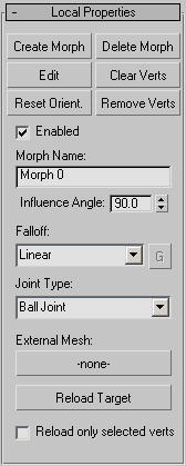

This rollout contains functions for creating and editing individual morphs. The settings, such as Morph Name and Influence Angle, are specific to each morph.
- Create Morph
Sets a morph at the current frame for the highlighted bone. Also sets the “pose” for this morph, using the bone's current orientation, and sets the bone to 100%, as shown in the list window hierarchical view. When you edit the morph, the skinned object returns to and stays at this orientation.
When you create a morph, the modifier displays, in orange, all vertices that are part of the current pose (that is, they're offset from the initial pose). Also, the modifier creates a default name for the morph and adds it as a child to the highlighted bone in the list window.
Tip: By default, the Show Edges switch is on, which might make it difficult to see the vertices themselves. To see only the vertices, turn off Options rollout
Show Edges. Tip: To help keep track of morphs, use the Local Properties rollout to rename each morph as you create it. - Delete Morph
Deletes the highlighted morph, removing it from its parent bone in the list window. Available only when a morph is highlighted.
- Edit
Lets you shape the current morph by transforming vertices. To exit Edit mode, click the Edit button again.
Transforming a vertex in Edit mode creates a morph target. Each transformed vertex moves into the morph target position (or orientation or scale) as the morph value increases to 100.0, and then out of it as the morph value decreases, based on the angle of the bone driving the morph.
Transforming a vertex in Edit mode also changes its color from orange to yellow. This lets you easily see which vertices are part of the current morph.
Choosing Edit places the skinned object at the 100% “pose” orientation for this morph (see Create Morph, above). It also activates the Points sub-object level so you can transform vertices using the standard 3ds Max transform tools.
- Clear Verts
Keeps selected vertices in the morph, but resets their deltas (changes from the initial pose) to 0.
- Reset Orient(ation)
Sets the morph orientation to current orientation of the bone that controls the morph.
This lets you change the angle at which the morph has its greatest effect. For example, if you create a bulging bicep at frame 120, and later decide that the muscle should be largest at frame 150 instead, go to frame 150, choose the morph in the list box, and then click Reset Orientation.
- Remove Verts
Removes selected vertices from the current morph, which deletes any animation applied as part of the morph.
Use this command to save memory by removing vertices not part of the morph animation.
- Enabled
When on, the morph is active; when off, the morph doesn't appear in the animation, and is indicated in the list box with the text “Disabled.” Default=on.
The ability to enable and disable each morph individually lets you isolate the effect of each or test them in combination.
- Morph Name
Displays and lets you change the name of the current morph.
- Influence Angle
The angle around the bone's current orientation within which the morph takes place. Default=90.0.
This is an important parameter. Think of the influence angle as a cone around the bone at its orientation when you create the morph. Consider an example in which Influence Angle is set to the default value of 90.0 degrees. If the bone starts its rotation beyond 45 degrees away from the orientation at which the morph was created, the morph has no effect at that time. As the bone moves from 45 degrees away to the morph orientation, the morph increases to its full value. As the bone then rotates away, the morph gradually decreases until, at 45 degrees or more away from the morph orientation, the morph no longer appears.
Tip: Influence Angle is useful for isolating morphs; that is, to prevent overlapping of different morphs on the same bone. Reduce the value until one morph's contribution percent value (shown in the list box) falls off to 0.0 before the next one begins. - Falloff
Determines the rate of change of the morph as the bone moves within the influence angle. Use the drop-down list to choose one of four different falloff types: Linear, Sinual, Fast, or Slow. If you choose Custom Falloff, you can then click the G (for Graph) button and edit the falloff using standard curve-graph controls.
Note: The default graph, displayed when you first access the falloff graph, shows the Sinual falloff type. - Joint Type
Determines how the modifier tracks the angular motion of the bone. This is a per-bone setting, not per-morph. Default=Ball Joint.
- Ball Joint Tracks all rotation of the bone. Use this setting in most cases.
- Planar Joint Tracks rotation of the bone only in the plane of its parent bone.
- External Mesh
Lets you use a different mesh as a morph target. Click the button (default label=-none-) and then select the target object. The target object should have the same mesh structure as the Skin Morph object. After specifying an external mesh, its name appears on the button.
Using an external mesh makes it easier to set up morph targets in a target mesh that uses a reference pose, rather than the skinned, animated mesh of which sections might be interpenetrating, making it difficult to select the specific vertices to be morphed. In this situation, it's probably best to turn Reload Only Selected Verts.
Note: The external-mesh connection is not live; if you edit vertices in the external mesh, Skin Morph doesn't automatically recognize the changes. To update the vertex positions after editing the external mesh, use Reload Target (see following). - Reload Target
Updates the Skin Morph object with edited vertex positions from the external mesh.
- Reload only selected verts
When on, Reload Target copies only the positions of vertices selected in the Skin Morph mesh from the target mesh. When off, Reload Target copies the positions of all vertices. Default=off.
