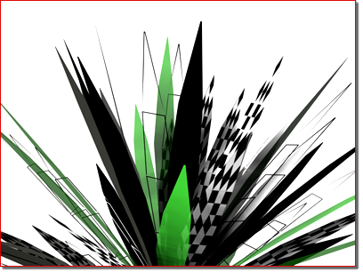

The MaterialByElement modifier lets you apply different material IDs to objects containing multiple elements, at random or according to a formula. When animated, this effect is useful for such applications as an office building at night with window illumination turning on and off at random.
Various materials randomly applied to the leaves of the plant

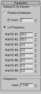

Interface
Material ID By Element group
The two choices in this group let you create either a truly random distribution of material IDs or divide the assignments among up to eight materials according to percentages you set.
- Random Distribution Assigns the material IDs at random to different elements in the object.
- ID Count The minimum number of material IDs to assign when using the Random Distribution option. Because material ID assignment is random, setting it to the number of materials in the Multi/Sub-Object material or higher doesn't guarantee that all materials get used.
- List Frequency Determines an approximate relative weight (percentage) for each of up to eight material IDs, as set by the Mat'l ID #1-8 parameters. The modifier assigns material IDs until the weights total 100.
For example, if you set Mat'l ID #1 to 40, #2 to 35, and #3 to 60, approximately 40 percent of the elements will be assigned material ID 1, 30 percent will be assigned material ID 2, and 25 percent (100 − [40 + 35]) will be assigned material ID 3. Any remaining percentages (as set in Mat'l IDs 4-8) are ignored.
Note: These percentages are approximate. The more elements the object contains, the closer the assigned percentage comes to the set percentage.
Uniqueness group
- Seed
Sets the seed value for the (pseudo-)randomization of material ID assignments. Not animatable.
