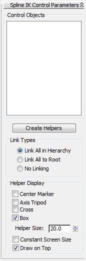

Interface
- Control Objects list
When helpers are created, knot numbers and their corresponding names appear here. Knot #1 is placed at the first vertex on the spline, and additional knots are numbered in sequence.
- Create Helpers
Places a helper at each knot, and displays knot numbers and helper names in the Control Objects area. Helper display is based on selections in the Helper Display group. Helpers are linked upon creation if a linking option is selected in the Link Types group.
Link Types group
These options cause helpers to be linked upon creation.
- Link All in Hierarchy Links each helper to its immediately previous helper. For example, the helper at knot #3 is linked to the helper at knot #2, while the helper at knot #2 is linked to the helper at knot #1.
- Link All to Root Links each helper to the helper at knot #1.
- No Linking Helpers are not linked.
When you click Create Helpers, 3ds Max can place one or more Point helper objects at each knot, making it easier to move and animate the knots. You can enable more than one type of helper.
- Center Marker
Places a small X-shaped Point helper at each knot.
- Axis Tripod
Places a small tripod-axis-shaped Point helper at each knot.
- Cross
Places a small cross-shaped Point helper at each knot.
- Box
Places a small box-shaped Point helper at each knot.
- Size
Sets the size for helpers.
- Constant Screen Size
Keeps the sizes of helpers constant regardless of the zoom extent of the viewports.
- Draw On Top
Displays the helpers on top of all other objects in the scene for improved visibility in busy scenes.
Tip: To change the display of helpers after creation, select each helper and change selections on the Modify panel.
