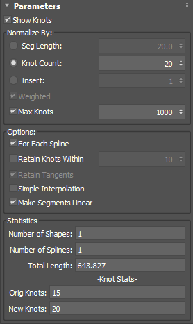

Parameters rollout
- Show Knots
- Displays knots on the spline.
Normalize By group
- Seg Length
- Sets the length of the spline's segments in 3ds Max units. The positions of the original vertices are discarded, and vertices are set to regular intervals. Segment length determines how many control points are added. Shorter segments result in more control points, longer segments result in fewer. Default=20.0 units.
- Knot Count
- Sets an exact number of knots instead of a segment length.
- Insert
- Inserts a specified number of knots between the existing knots in the shape.
- Weighted
- Inserts knots based on the average length of the segment rather than evenly distributing them.
- Max Knots
- When enabled, adjusts the segment length if necessary to prevent very high segment counts.
Options group
- For Each Spline
- Specifies the number of knots to use for each spline rather than a total across all shapes.
- Retain Knots Within
- Attempts to keep existing knot locations falling a certain tolerance in 3ds Max units. This option works with both Seg Length and Knot Count normalization methods.
- Retain Tangents
- Keeps the tangents for retained knots.
- Simple Interpolation
- Uses knot percentage to interpolate instead of the actual curve length.
- Make Segments Straight
- Forces the curve type to straight.
Statistics group
- Number of Shapes
- Shows the total number of shapes being affected.
- Number of Splines
- Displays the total number of splines being affected.
- Total Length
- Shows the total length of the created spline.
- Orig Knots
- Shows the original number of knots in the spline.
- New Knots
- Show the number of knots after the normalize operation.
