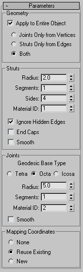

Interface
Geometry group
Specifies whether to use the whole object or selected sub-objects, and which of the two components (struts and joints) is displayed.
- Apply To Entire Object
- Applies Lattice to all edges or segments in the object. When turned off, applies Lattice only to selected sub-objects passed up the stack. Default=on. Note: When Apply To Entire Object is turned off, unselected sub-objects render normally. For example, if you convert a box to an editable mesh, select one polygon, and then apply Lattice with Apply To Entire Object turned off, the face does not render, while the edges and vertices that form that face are converted to struts and joints, and the remaining faces render normally. However, if you select the four edges surrounding the polygon and turn off Ignore Hidden Edges, the struts and joints are added to the object while all faces render as normal. If you turn on Struts group
Ignore Hidden Edges, one of the polygon's faces renders, while the other doesn't.
- Joints Only From Vertices Displays only the joints (polyhedra) generated by the vertices of the original mesh.
- Struts Only From Edges Displays only the struts (cylinders) generated by the segments of the original mesh.
- Both Displays both struts and joints.
Struts group
Provides controls that affect the geometry of the struts.
- Radius
- Specifies the radius of the struts.
- Segments
- Specifies the number of segments along the struts. Increase this value when you need to deform or distort the struts with subsequent modifiers.
- Sides
- Specifies the number of sides around the perimeter of the struts.
- Material ID
- Specifies the material ID to be used for the struts. The struts and the joints can have different material IDs, making it easy to assign them different materials. The struts default to ID #1.
- Ignore Hidden Edges
- Generates struts only for visible edges. When turned off, generates struts for all edges, including the invisible edges. Default=on.
- End Caps
- Applies end caps to the struts.
- Smooth
- Applies smoothing to the struts.
Joints group
Provides controls that affect the geometry of the joints.
- Geodesic Base Type
- Specifies the type of polyhedron used for the joints.
- Tetra Uses a tetrahedron.
- Octa Uses an octahedron.
- Icosa Uses an icosahedron.
- Radius
- Specifies the radius of the joints.
- Segments
- Specifies the number of segments in the joints. The more segments, the more spherical the joints' shape.
- Material ID
- Specifies the material ID to be used for the joints. Defaults to ID #2.
- Smooth
- Applies smoothing to the joints.
Mapping Coordinates group
Determines the type of mapping assigned to the object.
- None Assigns no mapping.
- Reuse Existing Uses the mapping currently assigned to the object. This might be the mapping assigned by Generate Mapping Coords., in the creation parameters, or by a previously assigned mapping modifier. When using this option, each joint inherits the mapping of the vertex it surrounds.
- New Uses mapping designed for the Lattice modifier. Applies cylindrical mapping to each strut, and spherical mapping to each joint.
