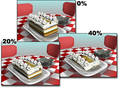

The Melt modifier lets you apply a realistic melting effect to all types of objects, including editable patches and NURBS objects, as well as to sub-object selections passed up the stack. Options include sagging of edges, spreading while melting, and a customizable set of substances ranging from a firm plastic surface to a jelly type that collapses in on itself.
Increasing the Melt amount progressively melts the cake

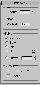

Parameters rollout
Melt group
- Amount
Specifies the extent of the "decay," or melting effect applied to the gizmo, thus affecting the object. Range=0.0 to 1000.0.
Spread group
- % of Melt
Specifies how much the object and melt will spread as the Amount value increases. It's basically a "bulge" along a flat plane.
Solidity group
Determines the relative height of the center of the melted object. Less-solid substances like jelly tend to settle more in the center as they melt. This group provides several presets for different types of substances, as well as a Custom spinner for setting your own solidity.
- Ice (The default.) The solidity of frozen water.
- Glass A high solidity to simulate glass.
- Jelly A low solidity to simulate jelly. Causes a significant drooping effect in the center.
- Plastic A medium-low solidity to simulate plastic. Relatively solid, but droops slightly in the center as it melts.
- Custom Lets you choose a custom solidity value between 0.2 and 30.0.
Axis To Melt group
- X/Y/Z
Choose the axis (local to the object) on which the melt will occur. Note that this axis is local to the Melt gizmo and not related to the selected entity. By default, the Melt gizmo's axes are lined up with the object's local coordinates, but you can change this by rotating the gizmo.
- Flip Axis
Normally, the melt occurs from the positive direction toward the negative along a given axis. Turn on Flip Axis to reverse this direction.
