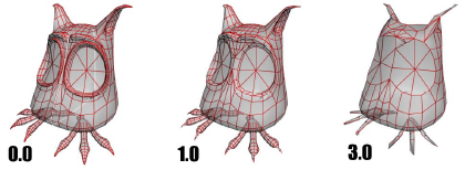

The results of using different Vertex Weld threshold settings
The new vertex is automatically placed at the average position of the combined vertices. Because the original vertices are removed, some associated faces and edges are usually removed as well. Also, welded vertices need not belong to the same element, so welding can result in combining elements within an object.

Threshold
The distance, in scene units, within which vertices are automatically combined. Vertices farther apart than this value are not welded. Default=0.1
Note: A higher Threshold setting results in welding more vertices, thus removing smaller faces and details. If the threshold is set too high, the mesh will begin to deform.
A threshold setting of 5.5 removes all detail, making the model unrecognizable.
