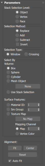

Parameters rollout
Stack Selection Level group
- Object/Vertex/Face
- Volume Select provides three selection levels. Vertex and Face levels put the modifier stack in sub-object selection. You can make one sub-object selection for each Volume Select modifier. You can then toggle the one selection between Face and Vertex level to send either up the stack. Object (top) level lets you modify the whole object while retaining any sub-object selection.
Selection Method group
- Replace Clears any selection passed up the stack to the Volume Select modifier, and then selects geometry within the volume.
- Add Selects all geometry within the volume, adding to any previous selection.
- Subtract Deselects all geometry within the volume.
- Invert
- Reverses the entire selection set. Geometry that was unselected becomes selected, and vice versa.
Selection Type group
Lets you determine whether selected faces are wholly or partially within the defined volume when you set Stack Selection Level to Face.
- Window Selects only faces with all three vertices within the selection volume.
- Crossing Selects faces with only one vertex within the selection volume.
Select By group
These controls let you define the selection with a primitive, a mesh object, or by surface characteristics.
- Volume
- Box/Sphere/Cylinder To define the selection space using a standard primitive-shaped gizmo, choose one of these. You can then scale, rotate, or move the gizmo anywhere around the object.
- Mesh Object Choose this option to use another object to define the selection space. After choosing Mesh Object, click the button below it (labeled "None" by default), and then select an object to use as the volume.
Besides mesh objects, you can use patch objects and NURBS objects. In addition, if you turn on Soft Selection rollout
Use Soft Selection, you can use spline objects and particle systems to define the selection. This latter option is quite powerful because the selection changes as the particles move.
[Mesh Object button] Click this button, then select an object to define the selection space. You don't need to choose Mesh Object first, but you do need to choose Mesh Object to use the object as a volume. After you select an object, its name appears on the button. This button is labeled "None" if no object has been chosen.
Note: The selection depends on a volume intersecting the object. If a gizmo or object is scaled down and moved inside an object, no selection occurs because no geometry is within the volume of the gizmo. - Use Stack Selection
- When active, this option locks your current stack selection. With this button, you can switch between the selection that is being passed into the modifier, or modify that selection with the tools and functionality that already exist within the modifier.
- Surface Features
Defines the selection by surface characteristics instead of a geometric volume. While this doesn't have much to do with volume, it was added because Volume Select is a procedural modifier, whereas Mesh Select is explicit. Now, even if your topology changes, Volume Select will consistently select the faces or vertices using a particular material or smoothing group.
Indicate which type of surface characteristic to base selection on by choosing one of the following:
- Material ID Specifies a material ID. All faces or vertices using the ID indicated by the spinner value are selected.
Note: Starting in 3ds Max 2024.2, the Material ID parameter can be animated, letting you drive selections at different points along your timeline.
- Sm Group Specifies a smoothing group. All faces or vertices using the ID indicated by the spinner value are selected.
Note: Starting in 3ds Max 2024.2, the Sm. Group parameter can be animated, letting you drive selections at different points along your timeline.
- Texture Map Specifies a texture map from the scene. Click the map button (labeled "None" by default) to open the
Material/Map Browser and choose a texture map to use for selection. All faces or vertices using that texture map will be selected. When using the Texture Map option, you can also specify a mapping channel or the vertex color channel using the Map/Vertex Color radio buttons and spinner.
You can also drag and drop a map from a Material Editor sample slot. If the Slate Material Editor is open, you can drag from a map node's output socket, then drop onto this button. You can also drag and drop from a map button in the Material Editor or anywhere else in the 3ds Max interface. When you drop a map onto the map button, a dialog asks if you want the map to be a copy (independent) or an instance of the source map.
To adjust the map's parameters (for example, to assign a bitmap or change the coordinate settings), drag the Map button to the Material Editor, and be sure to drop it as an instance. In the Compact Material Editor, drop the map over an unused sample slot. In the Slate Material Editor, drop it over the active View.
Note: You must apply mapping to the object below Vol. Select in its stack for the Texture Map selection to work. That is, the Vol. Select modifier must have mapping coordinates passed up the stack so it can use a texture map for selection.Note: If you set Selection Type to Window, vertices will be selected if all the faces they touch use the specified material or smoothing group. If you set Selection Type to Crossing, vertices will be selected if they touch any face using the specified material or smoothing group.
Alignment group
These controls are generally used when the gizmo has been transformed out of its original orientation to the object.
- Fit
Resizes the gizmo to fit around the object or previous selection in the stack. Maintains any previous rotation.
- Center
Recenters the gizmo on the object or previous selection in the stack. Maintains any previous scale or rotation.
- Reset
Returns the gizmo to its default size and orientation. Cancels the effect of all previous transforms.
- Auto Fit
When on, automatically adjusts the gizmo size and shape to fit the object as you change the underlying topology (for example, transforming vertices).
These controls, available only at the Vertex stack selection level, let you set a gradual falloff of influence between selected and unselected vertices. See Soft Selection Rollout (Edit/Editable Mesh).
