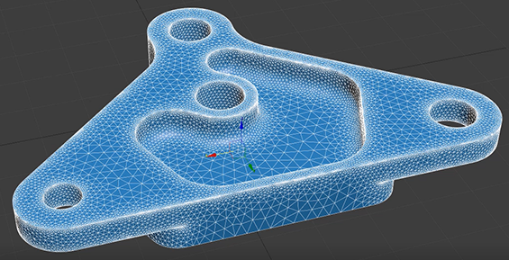

The Subdivide modifier provides a number of algorithms for generating a refined, triangulated representation of the input geometry. In addition to simply refining the mesh, the Adaptive and Variable Curvature algorithms in particular tend to produce a high-quality triangulation, consisting predominantly of roughly equilateral triangles. Remeshing via the Subdivide modifier can be helpful in obtaining a well-conditioned input mesh for complex geometric process operations, such as the retopology operations offered by Autodesk Retopology Tools for 3ds Max, or for rendering with the radiosity renderer. A more dense mesh also allows for finer lighting detail and accuracy during rendering.
Object with Subdivide modifier applied and Variable Curvature mode selected

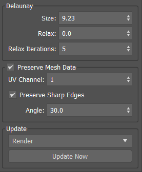

Delaunay mode
- Size
- Sets the target face length scale on the output mesh. This is similar to edge length in other modes.
- Relax
- Sets the blending between relaxed and unrelaxed vertex positions at each relaxation iteration. A value of 1.0 yields a fully relaxed result.
- Relax Iterations
- Sets the number of relax iterations to apply to the output mesh.
- Preserve Mesh Data
- When enabled, mesh data, such as smoothing groups, material IDs, Boolean seams, normals, specified UVs, and vertex float data channels, will be preserved with Subdivide. This can help in a modifier such as Retopology, where you might use this mesh data as an auto edge constrict.
- When this option is disabled, mesh data is cleared with the subdivide results.
- UV Channel
- UV Channel is only active when Preserve Mesh Data is on. The specified map channel will be indexed and preserved for which map coordinates and seams should be propagated to the output mesh.
- Preserve Sharp Edges
- Enables the propagation of hard edges to the output mesh. The detected edges are based upon the angle between adjacent face normals. This setting influences the degree of refinement near such edges, similar to how the Smooth modifier uses the edge angle threshold to determine hard and soft edges.
- Angle
- Sets the angle in degrees above which hard edges will be detected.
