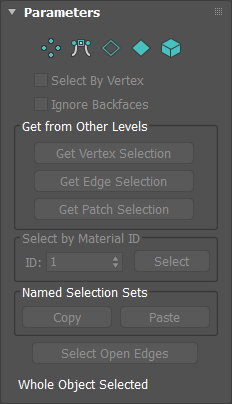

Parameters rollout
Provides buttons for turning different sub-object modes on and off, working with named selections and handles, display settings, and information about selected entities.
The icons at the top of the Selection rollout let you specify the method of face selection. Clicking a button here is the same as selecting a sub-object type in the modifier stack. Click the button again to turn it off and return to the object selection level.
Vertex -
Selects a vertex beneath the cursor; region selection selects vertices within the region.
Handle -
Selects a handle beneath the cursor; region selection selects multiple handles within the region.
Edge -
Selects an edge beneath the cursor; region selection selects multiple edges within the region.
Patch -
Selects a patch beneath the cursor; region selection selects multiple patches within the region.
Element -
Selects all contiguous faces in an object; region selection selects the same.
- Select By Vertex
Selects any sub-objects at the current level that use a vertex you click. Applies to all sub-object levels except Vertex. Also works with Region Select.
- Ignore Backfaces
Selects only those edges, patches, or elements whose normals make them visible in the viewport. When turned off (the default), selection includes all sub-objects, regardless of the direction of their normals.
Note: The state of the Backface Cull setting in the Display panel doesn't affect sub-object selection. Thus, if Ignore Backfacing is turned off, you can select sub-objects even if you can't see them.Note: The state of the Ignore Backfaces checkbox also affects edge selection at the Edge sub-object selection level.
Get from Other Levels group
Applies selections from one sub-object level to another.
- Get Vertex Selection
Selects edges, patches, or elements based on the last vertex selection. The selection is added to the current selection. Available only when Vertex is not the current sub-object level.
- Get Edge Selection
Selects vertices, patches, or elements based on the last edge selection. Selects those vertices, patches, or elements that contain the edge. Available only when Edge is not the current sub-object level.
- Get Patch Selection
Selects vertices, edges, or elements based on the last patch selection. This selection is added to the current selection. Available only when Patch is not the current sub-object level.
Select by Material ID group
Selects faces based on their material ID.
- ID
Set the spinner to the ID number you want to select, and then click the Select button. Press Ctrl while clicking to add to the current selection, or press Alt to remove from the current selection.
Named Selection Sets group
These functions are primarily for copying named selection setsof sub-objects between similar objects, and between comparable modifiers and editable objects. For example, you can apply a patch select modifier to a sphere, create a named selection set of edges, and then copy the selection to a different sphere that's been converted to an editable patch object. You can even copy the selection set to a different type of object, because the selection is identified by the entities' ID numbers.
The standard procedure is to create a selection set, name it, and then use Copy to duplicate it into the copy buffer. Next, select a different object and/or modifier, go to the same sub-object level as you were in when you copied the set, and click Paste.
- Copy
Places a named selection into the copy buffer.
- Paste
Pastes a named selection from the copy buffer.
- Select Open Edges
Selects all edges with only one face. In most objects, this will show you where missing patches exist. Available only at the Edge sub-object level.
- Selection Info
- At the bottom of the Patch Select Parameters rollout is a text display giving you information about the current selection. If 0 or more than one sub-object is selected, the text gives the number and type selected. If one sub-object is selected, the text gives the ID number and type of the selected item.
Note: When the current sub-object type is Patch or Element, selection information is given in Patches.
