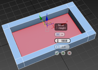

- Go to the Polygon sub-object level, select the inside polygon on the top of the box, and extrude it inward about 10 units. Exit Extrude mode.
Note: 3ds Max provides various methods for achieving a result similar to this, but this one is particularly apt for examining the Chamfer modifier options.

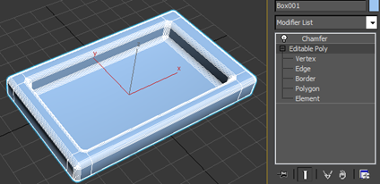

To demonstrate the main Chamfer modifier features, let's create a simple tray-like object.
Part 2: Apply the Chamfer modifier and change settings:
- Go to the Edge sub-object level and select the four inner edges at the top of the box.
- From the Modifier List on the Modify panel, choose Object-Space Modifiers
Chamfer.
This applies the Chamfer modifier to the object and opens the Chamfer rollout on the Modify panel where you can adjust the settings.

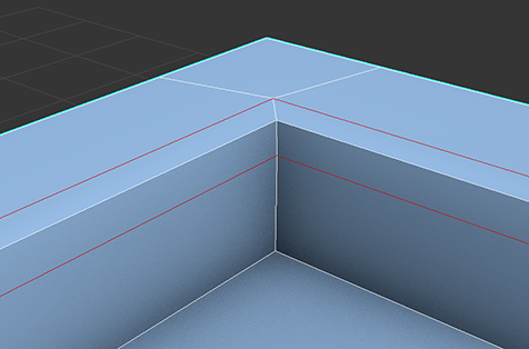

- Zoom into a corner to better see the results. As you can see, the four edges have been chamfered, with even, connected corners. The output is the result of the Uniform option, which is the default Mitering setting on the Corner Options rollout.

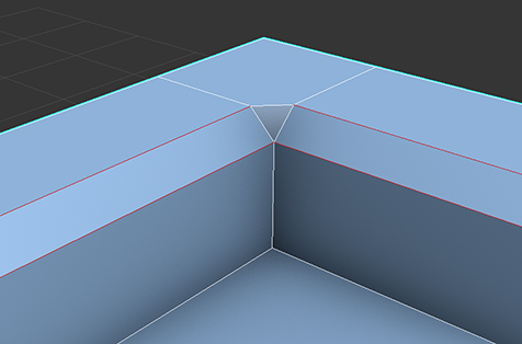

- Under Corner Options, set Mitering to Tri, which replicates the legacy Standard option of previous versions.
Note that the polygons at the corners are now triangles. Triangular polygons can lead to unpredictable results when modeling, so it's better to work with quads whenever possible.

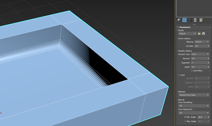

- Set Selection to Selected Face Edges.
This applies the chamfering to all edges of the polygon selection on the stack, including the "inside" edges between adjacent selected polygons. This produces chamfering of the inner vertical edges.

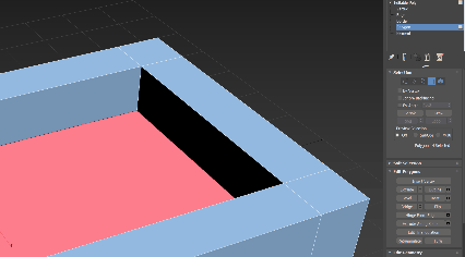

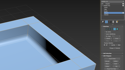

- Select Editable Poly again and click on the Polygon button.
- Turn off Show End Result (
) to better see your selection. Then select one of the inside walls of the box and hold Shift and click the face next to it. This will select the entire loop of faces.

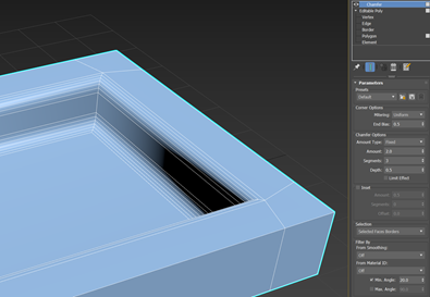

- Go back to the Chamfer modifier and set Selection to Selected Faces Border.
A border comprises only edges on the perimeter of each contiguous polygon selection. So with the Selected Faces Border option, interior edges such as the vertical corners are not chamfered.
