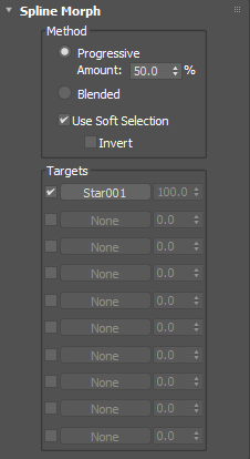

Spline Morph rollout
- Show Knots
- Displays spline knots.
Method group
- Progressive
- Blends splines progressively using a percentage value.
- Amount
- Sets how much to progressively blend between the original object and the targets as a percentage of the total number.
- Blended
- Combines the targets and weighs each one according to the values provided in the Targets group.
- Use Soft Selection
- Morphs between the targets based on each knot's soft selection value, if available.
- Invert
- Inverts the soft selection value. If no soft selection is available, this option is ignored.
Targets group
- Pick button
- Selects a target spline from the scene. Only splines with an identical number of knots may be selected.
Tip: You can use the Optimize Spline and Normalize Spline modifiers to adjust the source or target knot count, or convert to an editable spline and manually add new knots as required.
- Amount
