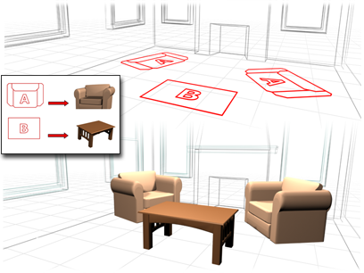

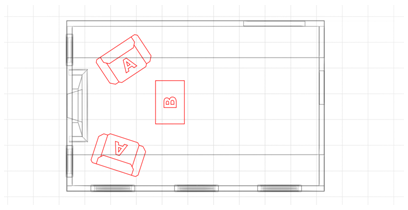

Typically, designers use two-dimensional shapes to represent objects, such as furniture, in their AutoCAD designs. However, when they link their DWG files into 3ds Max for visualization, they want to see how the objects will look in their design.
Top view of 2D symbols used to represent 3D objects
The Substitute modifier lets you quickly replace one or more objects with another in the viewports or at render time. The substitute object can be instanced from the current scene or can be referenced from an external file.
The Substitute modifier replaces the 2D objects with their 3D counterparts.
To get rid of the substitute object, simply remove the modifier from the stack. This frees up the memory required to store it.

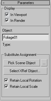

Parameters rollout
Display group
- In Viewport
Replaces the original object with the substitute in the viewports.
- In Render
Replaces the original object with the substitute when you render the scene.
- Object
This editable text field displays the name of the substitute object and lets you rename it.
Note: The name, if changed, appears only on the Modify panel at the current stack level. That is, the name is local to the current application of the Substitute modifier. - Type (label)
Displays the type of object used as a substitute. If you use a scene object, the type is shown as Instance. If you use an XRef object, the type is shown as XRef Object. Appears only after you designate a substitute object.
Substitute Assignment group
- Pick Scene Object
Lets you choose an object from the current scene to be instanced as a substitute for the selected object. Click Pick Scene Object, and then select the object from a viewport to use as a substitute. If In Viewport is on and Retain Current Position is off (the default settings), an instance of the substitute object appears in the place of the original object.
The mouse cursor changes to a plus sign (+) when over an object that can be used as a substitute. You cannot use an object to which the Substitute modifier is applied as a substitute object.
Use the button labeled "..." to the right of Pick Scene Object to choose a substitute object using the Select Substitute Object dialog, which works like the Select From Scene dialog. In the dialog's list window, highlight the object to use as a substitute, and then click Select.
- Select XRef Object
Lets you specify an object to be instanced from an external scene file as the substitute. Click Select XRef Object, and then, in the Open File dialog, open the file containing the substitute object. On the XRef Merge dialog, select the substitute object and then click OK. Objects to which the Substitute modifier is applied don't appear in the list.
Note: Because the object used as a substitute is referenced from an external file, any changes to the object in that file apply to the substitute after reloading. For example, if you apply a Bend modifier to the substitute object in the external file, then the next time you load the file containing the object with the Substitute modifier, it appears bent. - Retain Local Rotation/Scale
When on, rotates or scales the new object instance in the same place as the substitute object you select. In this case, the two objects coincide in space, and you must move one to see both. When off, 3ds Max positions the instanced substitute object in the same place as the object containing the Substitute modifier.
You must specify the Retain Local Rotation/Scale setting before designating the substitute object. Changing this setting afterward has no effect.
