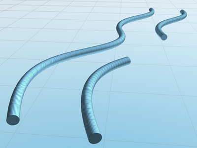

Delete Spline used to remove a segment in the middle of a spline.
Procedure
Use the delete spline modifier:
- Create a shape that contains multiple splines.
- Apply a Spline Select modifier and select a section of the spline for deletion.
- Apply a Delete Spline modifier to delete the section.
To undo the deletion,
remove the Delete Spline modifier.
