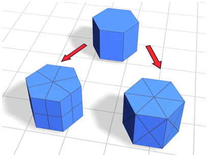

Top: Original mesh object
Lower left: Polygonal tessellation applied to edges
Lower right: Polygonal tessellation applied to polygon centers (Face-Center option)

Polygons Divides the polygonal facets. For example, using the polygonal method on the side of a box results in cross-shaped edges using the Edge method, and X-shaped edges using the Face-Center method.
- Edge/Face-Center
- Edge Divides the face or polygon from its center to the middle of each edge. When applied to a triangular face, it also divides unselected faces that share edges with the selected faces.
- Face-Center Divides the face or polygon from the center to the corner vertices.
