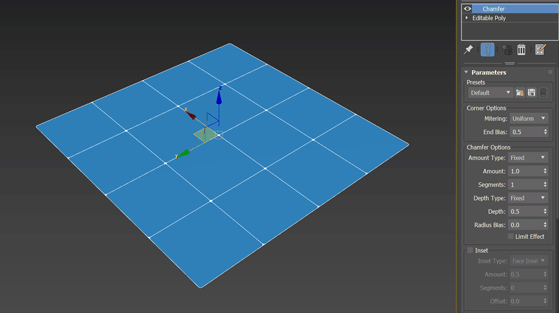

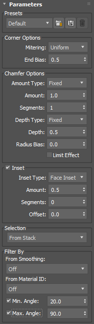

Parameters rollout
- Presets
- From the drop-down menu, choose from the list of preset chamfer settings.
- Click
to load a selected preset.
- Click
to save the current stack as a preset. When saving a preset, you must specify a name and an optional tooltip to show while hovering over the name in the list.
- Click
to delete the selected preset. A dialog will appear to confirm the action.
You can also right-click the drop-down menu and choose Set as default to apply the current settings as default.
- Click

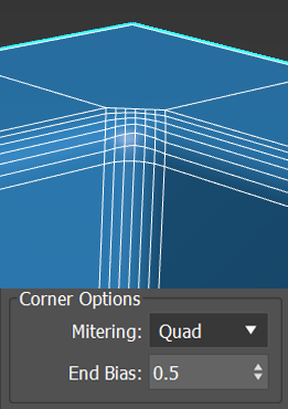

- Quad: creates new quadrilateral polygons around each chamfered edge (2 x the current Segments value). For example, setting Segments to 3 results in six new polygons per edge. The higher the Segments value used, the more the chamfer that can be rounded off, depending on the Tension value.

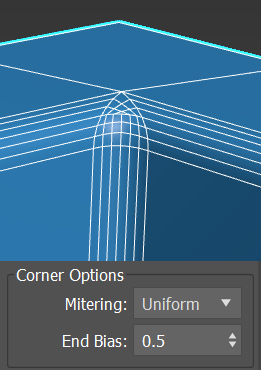

- Uniform: creates a uniform corner with quadrilateral intersections. A Uniform corner can be smoothed or sharpened depending on the Depth setting under the Chamfer options.

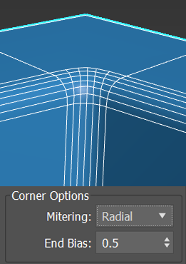

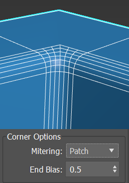

- Patch: creates a patch corner that also has quadrilateral intersections, however can provide higher resolution results and remove artifacts. A patch corner can be smoothed or sharpened depending on the Depth setting under the Chamfer options.
- Radial: creates a corner similar to Patch, however to do so produces an arc in the corners to avoid connecting bevel edge vertices to non-bevel edge vertices. A Radial corner can be smoothed or sharpened depending on the Depth setting under the Chamfer options.

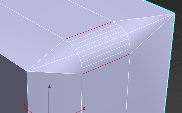

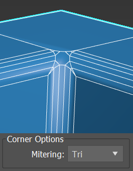

- Tri:
replaces each chamfered edge with a number of polygons equal to the current Segments value. This also increases the Segments value of chamfered edges between non-coplanar polygons, which can cause rounding of the chamfered area. This method generates both triangular and quadrilateral polygons.
Note: Using triangular polygons may cause mesh issues when smoothing or subdividing.

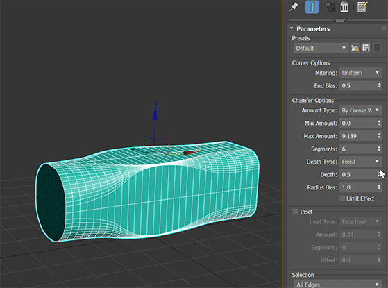

- By Weight: uses the Weight channel data from the mesh to drive the amount of chamfer. Weight can be adjusted in the Edge Properties group of Editable Poly or the Edit Poly modifier.
- By Crease Weight: uses the Crease Weight channel data from the mesh to drive the amount of chamfer. Crease weight can be adjusted in the Edge Properties group of Editable Poly or the Edit Poly modifier.
Tip: Use Crease Weight to interpolate the weight between the vertices, creating a blend along the edge of the weight. Use By Weight to maintain a consistent weight along the edge, interpolating the weight within the mitered corners.
Increasing chamfer amount with the By Crease Weight option enabled

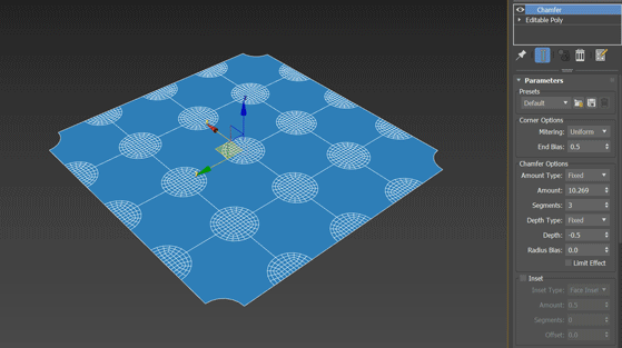

- Depth (Uniform, Patch, and Radial mitered corners only)
- Controls the fixed depth of the chamfer:
- A depth of 1.0 will produce a sharp corner on convex edges.
- A depth of 0.0 will produce a flat surface.
- A depth of -0.5 will produce a concave curve surface along a convex edge.
This option is not available for the Legacy amount type.

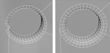

- Limit Effect
- When on, Helps prevent overshooting of edges by restricting the distance chamfered sub-objects can travel towards each other. In other words, when Limit Effect is on, increasing the Amount setting past a certain value (based on existing geometry) has no effect.
Tip: Starting in 3ds Max 2023.2, the Limit Effect output has been updated to prevent self intersections in chamfered surfaces. You can use the command $.modifiers[N].SetVersion #VerLatest to update Chamfer modifiers that were applied in previous versions of 3ds Max, so they use the new functionality.Note: When the Mitering option is set to Tri mitered corners, Limit Effect is always applied. This setting will remain in effect when changing from Tri to other mitered corners, so it must be turned off explicitly.
Left: original cylinder; Top right: Chamfered with Amount=8, Limit Effect off; Bottom right: Chamfered with Amount=8, Limit Effect on

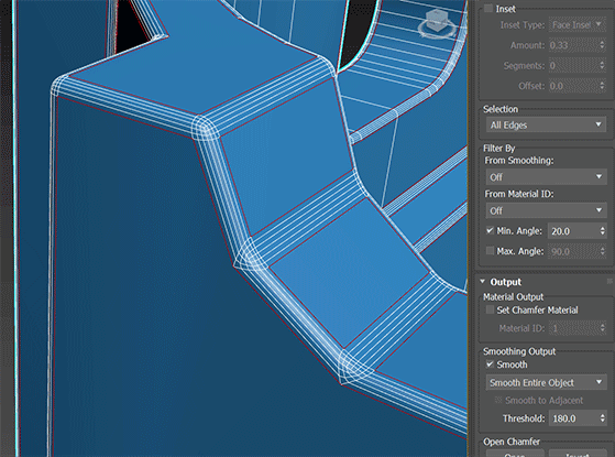

- Min. Angle
- When enabled while chamfering edges, the angle between faces below which edges are not chamfered.
For example, to prevent chamfering of edges between coplanar faces, turn on Min. Angle and set the value to 0.0.
