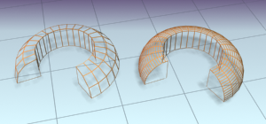

- Steps
- Sets the number of divisions, or steps, 3ds Max uses between each built-in section's vertices. Splines with tight curves require many steps to look smooth while gentle curves require fewer steps. Range=0 to 100.
Left: The quarter-round section is set to zero steps.
Right: The same section on the right is set to four steps.
