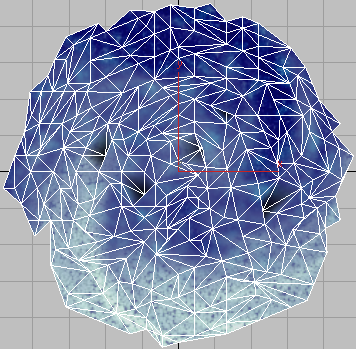

Crunch Borders active
Vertex % = 50.0
Vertices = 278
Faces are reduced but object borders are not preserved.

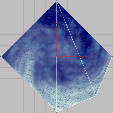

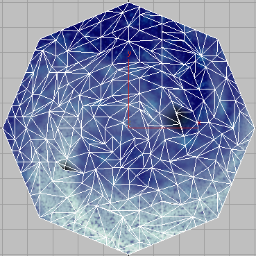

Protect Borders active
Vertex % = 50.0
Vertices: 557
Borders are preserved.
Vertex % = 1.0
Vertices: 5
Decreasing Vertex % or Vertex Count can cause borders to become distorted.

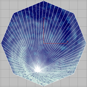

Exclude Borders active
Vertex % = 10.0
Vertices: 65
At low Vertex % values, Exclude Borders can interfere with optimization.
