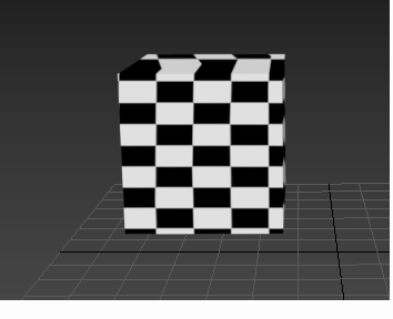

When enabled (default), the UV map projection is updated on each frame from the new location of the camera.
Animated Camera parameter = turned on

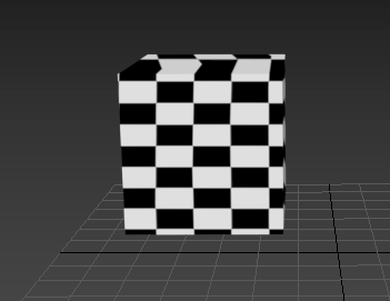

When disabled, the UV map projection is not updated on each frame.
Animated Camera parameter = turned off
