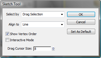

Sketch Tool Dialog

  1. Choose Sketch Vertices.
  2. On the Sketch Tool dialog, from the Select By drop-down list, choose Drag Selection, if necessary.
  3. From the Align To drop-down list, choose Free Form, if necessary.
  4. Make sure Show Vertex Order and Interactive Mode are on. Leave Drag Cursor Size at the default setting.
  5. Click OK to close the dialog.

Interface
Select by
Lets you choose how to select the vertices to sketch:
  • Pick Selection Lets you pick the vertices one by one. When you click OK, a Pick cursor appears comprising a + sign and the letter P; when the cursor is over a vertex, the + sign becomes larger. To finish picking, right-click, and then drag to sketch. After sketching, you return to Pick mode, and so on. To exit, right-click.
  • Drag Selection Lets you pick multiple vertices by dragging. When you click OK, the mouse cursor appears as a circle. After you drag to select vertices, release the mouse button, and then drag (or Alt+click) to sketch. As with Pick Selection, the mouse cursor continues to alternate between Select and Sketch modes until you right-click to exit.
  • Use Current Selection Uses the current selection; you cannot change the selection while using the tool. If the current selection is edges or faces, Sketch uses all vertices attached to selected sub-objects.
Align To
Lets you choose how to sketch:
  • Free Form Drag to sketch free form (like drawing with a pencil), or Alt+click to sketch connected
  • Line Drag to sketch a single, straight line segment.
  • Box Drag diagonally to sketch a rectangle.
  • Circle Drag outward to sketch a circle, and then move the mouse in a circle to rotate the circle.
Show Vertex Order
Displays numbered labels that indicate the order in which vertices were selected and will spread out during sketching.
Interactive Mode
Shows vertex positioning as you sketch. Turn off for faster feedback.
Drag Cursor Size
Sets the size of the mouse cursor used while dragging a selection. Default=8. Range=1 to 15.
OK
Accepts the changes and closes the dialog.
Cancel
Undoes any changes and closes the dialog.
Set As Default
Makes the current settings the defaults for the current session.
