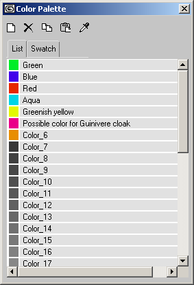

To use the color picker:
- In the Palette's List panel, highlight the name of a color.
- Click
(Color Picker) to turn it on. The cursor changes to an eyedropper icon.
- Without depressing the mouse button, drag to an area where you want to pick a color.
You can obtain colors from viewports, the 3ds Max user interface, or anywhere on the Windows desktop.
- When you depress the mouse button, the picker obtains the color below the cursor. You can drag while the mouse button is depressed. While you do, the color swatch in the palette and the larger swatch on the Paintbox update.
- Release the mouse to pick the color you want.
The color in the Palette and the active color in the Paintbox are both updated.
To change a color's name:
- In the List panel, click the name twice (more slowly than a double-click).
The name changes to an editable field.
- Enter a new name or edit the existing one, and then press Enter.
Press Esc to cancel the name change.

- List panel
Displays the colors in the palette, along with their names.
