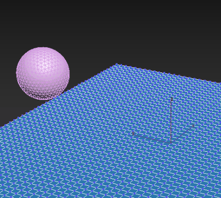

- Caches the deformation at a specific frame. In the following example, when the
Cache button is clicked halfway through the animation, the deformation is stored at that frame. Click
Cache again to remove the stored deformation.
Note: The plane in this example has a Volume Select modifier with soft selection applied, which lets you make a sub-object selection of vertices for passing up the stack to another modifier. In this scenario, the soft selection area is visible as the conform object moves across the target surface.
