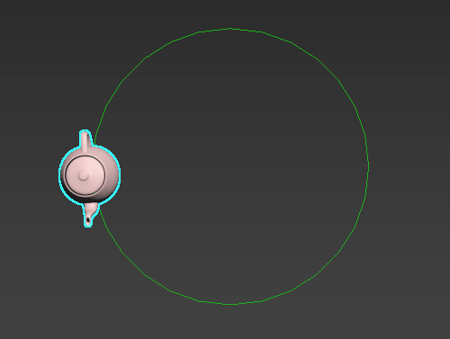

Distribution method creates clones along a target spline in your scene and provides controls to project your array onto a reference surface in your scene. The following example uses the
Spline
Distribution method to create a chain. See
Create a chain using the Array Modifier for a detailed workflow example.

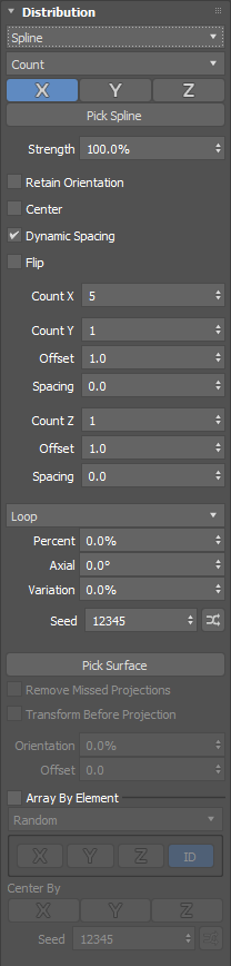

Interface
- Layout method
- Lets you select the way clones are placed along the target spline.
Note: The parameters that appear below the Layout Method drop-down list update dynamically based on your selection.

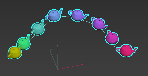

- Count
- Distributes the number of clones specified in the
Count X and
Count Y parameters along the length of the spline. In the following example,
Count X is increased incrementally until reaching a value of eight.

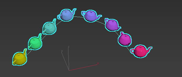

- Relative Offset
- Distributes a fixed number of clones along the length of a spline, starting at a knot point. In the following example,
Tip: When your spline has zero thickness, use the Spacing parameter to set the distance between clones. - Fill
- Distributes clones along the spline path from start to end.
- Knots
- Distributes clones along a target spline, placing a clone on each knot. When specific knots are selected., clones are only placed on the selected knots.
- Segments
- Distributes clones along a target spline, placing a clone on each segment. When specific segments are selected, clones are only placed on the selected segments.
- X,/Y/ Z
- Click a button to orient the array along the selected axis in object space.
- Pick Spline
- Select a reference spline from your scene. Clones take the same shape as the reference spline.
Tip: After you've selected a target spline, you can select a different target spline by doing one of the following:
- Right-click Pick Spline and select Clear Spline
- Click Pick Spline and then select a different target spline
- Strength
- Sets the position of the clones relative to the first knot of the spline.
- Retain Orientation
- When enabled, the clones retain the original object's orientation.
- Center
- Repositions the array so it is centered around the original object's origin.
- Flip
- Reverses the position and orientation of the clones along the spline.
- Count X/Count Y/Count Z
- This parameter is only available when the Layout method is set to Count or Relative Offset.
- Sets the number of clones placed along the local X/Y/Z axis.
- Offset
- Sets the distance to the next clone on the X/Y/Z axis in relative clone dimensions.
- Spacing
- Sets the distance between each clone on the X/Y/Z axis in display units.
- Position transform method
- Continue
- Uses the outgoing vector at the beginning or end of the spline and continues to place clones along the same trajectory.
- Loop
- (Default) Once clones reach the end of the spline path, they are placed back at the beginning, creating a loop.
- End
- Clones are stacked on top of each other at the location of the first clone.
- Remove
- Clones disappear once they reach the end of the spline path.
- Percent
- This parameter is only available when the Total Dimension or Fill layout methods are selected.
- Sets the position of the clones along the length of the spline.
- Axial
- Sets the placement of the clones around the axis of the spline.
- Variation
- Randomizes the position of the clones a percentage of the length of the spline.
- Seed
- Sets the random number seed for the variation value.
- Pick Surface
- Lets you pick a reference object from your scene to project your array onto.
Note: Projection is along the local -Z of the spline.

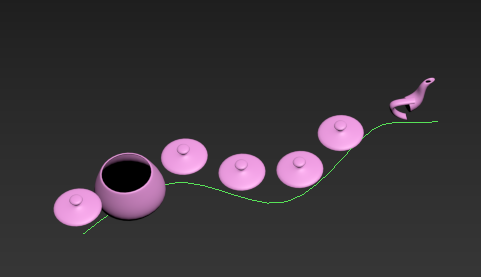

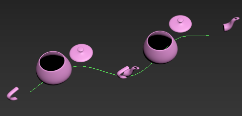

- Array By Element
- If the source object has multiple elements and this option is enabled, you can select from the following Array By Element methods to control the arrangement of clones.
- Random: Each element is randomly used as a potential clone. In the following example, the parameters used are
Count X: 8.
- Ordered: Elements are arranged in sequential order based on a selected orientation (X, Y, Z) or Clone IDs. In the following example, the elements of the teapot appear in sequential order along the X-axis, repeating after the array has cycled through all four elements. Additional parameters used are
Count X: 8.

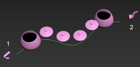

- First Middle Last: The first and last clone remain the same, and the remaining clones are arranged randomly. In the following example element 1 is the first clone and element 2 is the last clone. A Additional parameters used are
Count X: 8.
Note: A First Middle Last arrangement requires at least four elements in the object to provide the expected result.
