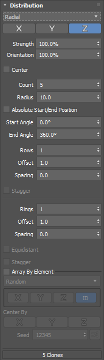

Interface
- X, Y, Z
- Orients the array along the selected axis in object space.
- Strength
- Sets the position of the clones relative to the array's origin. The default is 100%.
- Orientation
- Sets the orientation of the clones relative to the original object's orientation. The default value is 100%. At 100% the orientation of each clone is relative to the rotation from the center of the array. At 0.0% each clone adopts the orientation of the original object. Values between 0.0% and 100% set each clone to a percentage of the rotation in the array.
- Center
- Repositions the array so it is centered around the original object's origin. This parameter is off by default.
- Count
- Sets the number of clones in the array.
- Radius
- Sets the radius of the array in display units.
- Absolute Start/End Position
- When enabled, the first clone is positioned at the specified Start Angle, the last clone is positioned at the specified End Angle, and the remaining clones are spaced out evenly in between.
- This option is off by default.
- Start Angle
- Sets the starting position of the array. The default value is 0.0 and the default position is at the 12 o'clock position.
- End Angle
- Sets the ending position of the array with the last clone's position relative to the 12 o'clock position.
- Rows
- Sets the number of rows of clones in the array. Each additional row is placed in the positive axis specified.
- Offset
- Sets the distance between each row in relative clone dimensions. The default is 1.0.
- Spacing
- Sets the distance between each row. Spacing is measured in display units.
- Stagger
- Rotates each successive row half the width of a clone.
Note: This parameter is only available when there is more than oneRow in the array.
- Rings
- Sets the number of concentric rings of clones relative to the first ring.
- Offset
- Sets the distance between each ring in relative clone dimensions. The default is 1.0.
- Spacing
- Sets the distance between each ring. Spacing is measured in display units.
- Equidistant
- Adds as many clones as possible to each successive ring, filling the area defined by the Offset and Spacing parameters.
Note: Equidistant is only available there is more than one Ring in the array.
- Stagger
- Offsets each successive ring, creating a staggered appearance.
Note: The exact position of each clone is dependant on ring count and an even overlap is not guaranteed.

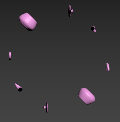

- Random: Each element is randomly used as a potential clone. In the following example, the parameters used are
Count: 8 and
Radius: 75.0.

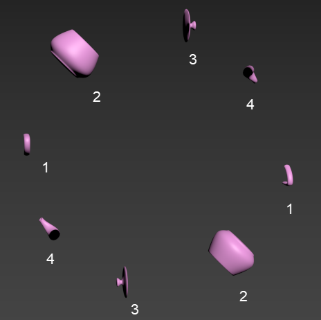

- Ordered: Elements are arranged in sequential order based on a selected orientation (X, Y, Z) or Clone IDs. In the following example, the elements of the teapot appear in sequential order along the X-axis, repeating after the array has cycled through all four elements. Additional parameters used are
Count: 8 and
Radius: 75.0.

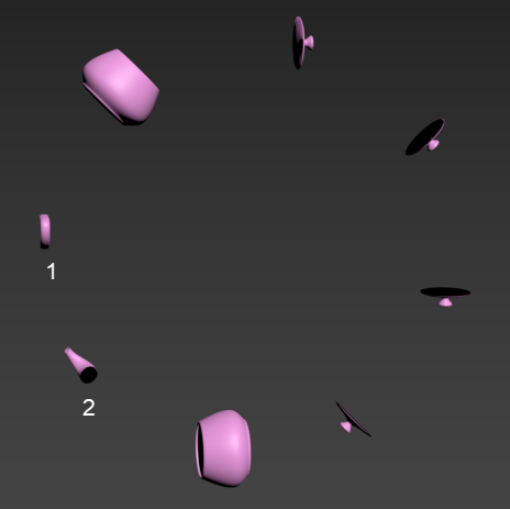

- First Middle Last: The first and last clone remain the same, and the remaining clones are arranged randomly. In the following example element 1 is the first clone and element 2 is the last clone. A Additional parameters used are
Count: 8 and
Radius: 75.0.
Note: A First Middle Last arrangement requires at least four elements in the object to provide the expected result.
Count: 8 and
Radius: 75.0.
