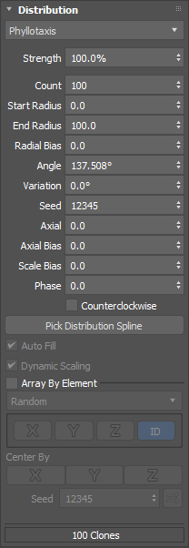

Interface
- Strength
- Sets the position of the clones relative to the array's origin.
- Count
- Sets the number of clones in the array.
- Start Radius
- Sets the minimum distance from the origin to the first clone.
- End Radius
- Sets the maximum radius of the last clone in the array.
- Radial Bias
- When set to a value that is greater than zero, clones are moved progressively toward the end radius. When set to a value that is less than zero, clones are moved progressively toward the start radius position.
- Angle
- Sets the radial angle of each successive clone in the array. The default angle, 137.508 is known as the Golden Angle and forms a phyllotactic spiral.
- Variation
- Each successive clone's location along the rotation distribution is slightly offset.
- Seed
- Controls the randomness at which the Variation can be applied to clones.
- Axial
- Sets the vertical position of the clones along the local Z axis of the array.
- Axial Bias
- Moves the clones progressively along the local Z axis when the value is set to anything other than zero.
- Scale Bias
- Scales the clones progressively, so clones in the later part of the array are either larger or smaller than the first clone.
- Phase
- Moves the clones along the spiral. For example, a value of 100% moves all the clones through the spiral.
- Counter Clockwise
- Changes the spiral orientation of the array to a counter-clockwise rotation.

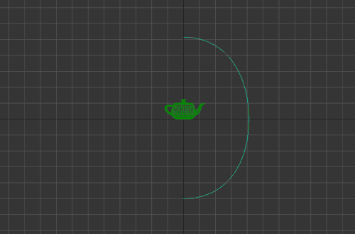

- Pick Distribution Spline
- Lets you pick a reference spline from your scene to use as a path for the clones in 3d space. Clones are dynamically placed in a spiral pattern, using the spline as a path.
Important: For predictable results, it's recommended that you consider the following best practices when using the Pick Distribution Spline parameter:
- To start, create a half profile spline in the front view.
Once you pick the reference spline, the array is rotated about the Z-axis in the same way as the Lathe modifier.
- The reference spline and the array object must be centered to one another, otherwise an offset may occur.
- Auto Fill
- Places as many clones as possible on the spiral based on the clone's scale.
- Dynamic Scaling
- Scales each clone relative to its initial size to optimally pack the spiral.

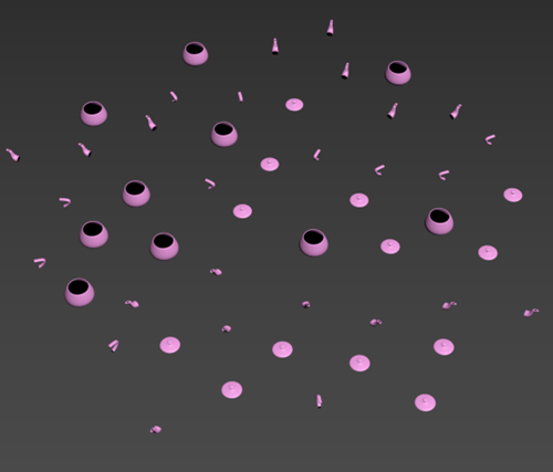

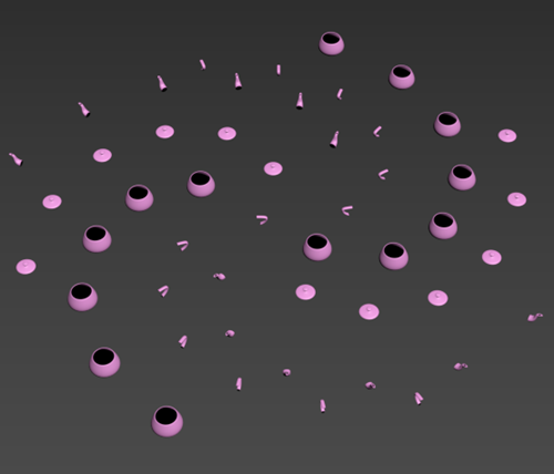

- Array By Element
- If the source object has multiple elements and this option is enabled, you can select from the following Array By Element methods to control the arrangement of clones.
- Random: Each element is randomly used as a potential clone.
- Ordered: Elements are arranged in sequential order, repeating after the array has cycled through all elements.

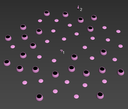

- First Middle Last: The first and last clone remain the same, and the remaining clones are arranged randomly. In the following example element 1 is the first clone and element 2 is the last clone.
Note: A First Middle Last arrangement requires at least four elements in the object to provide the expected result.
