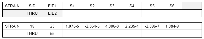

Element Initial Strain
Description: Defines the shell and solid element initial strain state for use in nonlinear analysis.
Format:
Example:
Alternate Format and Example:
Field Definition Type Default
SID Load set identification number. Integer > 0 Required
EID Element identification number. Integer > 0 Required
Si Strain component values. See Remark 5. Real 0.0
