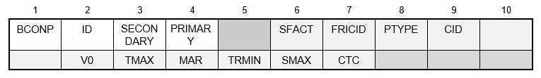

Slide Line Contact Parameters
Description: Defines the parameters for a slide line contact region.
Format:
Example:
Field Definition Type Default
ID Contact region identification number. Integer > 0 Required
SECONDARY Secondary region identification number. Integer > 0 Required
PRIMARY Primary region identification number. Integer > 0 Required
SFACT Stiffness scaling factor used to scale the penalty values determined automatically. See Remark 4. Real > 0.0 1.0
FRICID Contact friction identification number. See Remark 5. Integer ≥ 0 or blank
PTYPE Penetration type. See Remarks 6 and 7.
1 = Unsymmetric general contact (secondary penetration only)
2 = Symmetric general contact
3 = Unsymmetric welded contact
4 = Symmetric welded contact
5 = Unsymmetric bi-directional sliding contact
6 = Symmetric bi-directional sliding contact
7 = Unsymmetric rough contact
8 = Symmetric rough contact
1 ≤ Integer ≤ 8 1
CID Coordinate system identification number to define plane of contact. See Remark 9. Integer ≥ 0 or blank 0
V0 Penetration edge offset. See Remark 10. Real 0.0
TMAX Maximum allowable penetration used in the adjustment of penalty values normal to the slide line. A positive value activates the penalty value adjustment. See Remark 11. Real ≥ 0.0 See Remark 11
MAR Maximum allowable adjustment ratio for adaptive penalty values K and FSTIF. See Remark 12. Real > 1.0 100.0
TRMIN Fraction of TMAX defining the lower bound for the allowable penetration. See Remark 13. 0.0 ≤ Real ≤ 1.0 0.001
SMAX Maximum allowable slip used in the adjustment of penalty values parallel to the contact plane (FSTIF). A positive value activates the penalty value adjustment. See Remark 14. Real ≥ 0.0 0.0
CTC Contact thermal conductance. See Remark 15. Real ≥ 0.0

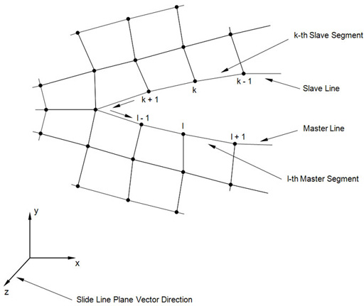

  9. Figure 1 shows a typical slide line contact definition. The slide line coordinate system z-axis defines the slide line contact plane. An alternate coordinate axis other than the z-axis may be specified using PARAM, SLINEPLANEZDIR (see Section 5, Parameters, for more information on SLINEPLANEZDIR). Relative motions outside the slide line plane are ignored and should be small compared to a typical primary segment. The normal direction for a slide line segment is formed from the cross product of the slide line plane vector and the vector from primary node 1 to primary node 2. The definition of the coordinate system should be such that the normal direction points toward the secondary region. For symmetric penetration the normals of the primary and secondary segments must face each other. This is generally accomplished by ordering the nodes on the primary and secondary lines either clockwise or counterclockwise depending on the direction of the slide line plane.

Figure 1. Slide Line Contact Definition
