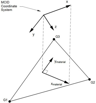

| THETA | Material property orientation angle in degrees. | Real | See Remark 4 |
| MCID | Material coordinate system identification number. | Integer ≥ 0 | See Remark 4 |

- If THETA/MCID is blank, field 5 of the PSHELL continuation entry will be used. If this field is also blank, then THETA = 0.0 is assumed when a non-isotropic material is referenced.

Figure 1. MCID Coordinate System Definition
