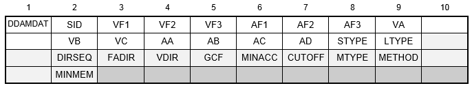

Dynamic Design Analysis Method Data
Description: Defines data needed to perform DDAM analysis.
Format:

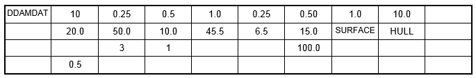

Example:
| Field | Definition | Type | Default |
| SID | Set identification number. | Integer > 0 | Required |
| VFi | Velocity scale factors. See Remark 1. | Real | Required |
| AFi | Acceleration scale factors. See Remark 1. | Real | Required |
| VA, VB, VC | Velocity weighting factors. See Remark 1. | Real | Required |
| AA, AB, AC, AD | Acceleration weighting factors. See Remark 1. | Real | Required, see Remark 2 |
| STYPE | Ship type, one of the following character variables: SURFACE for surface ship or SUBMERG for submerged. | Character | Required |
| LTYPE | Mounting location, one of the following character variables: DECK, HULL, or SHELL. | Character | Required |
| DIRSEQ | Shock direction sequence. (Up to three unique digits may be placed in the field with no embedded blanks.) See Remark 3. | 1 ≤ Integers ≤ 3 | 123 |
| FADIR | Forward-aft component number. See Remark 3. | 1 ≤ Integers ≤ 3 | 1 |
| VDIR | Vertical component number. See Remark 3. | 1 ≤ Integers ≤ 3 | 3 |
| GCF | Mass to weight conversion factor. | Real | 386.4 |
| MINACC | Minimum acceleration. See Remark 4. | Real | See Remark 4 |
| CUTOFF | Modal mass cutoff percentage. See Remark 5. | Real | 80.0 |
| MTYPE | Material type, one of the following character variables: ELASTIC or PLASTIC. See Remark 6. | Character | ELASTIC |
| METHOD | Response spectra generation method, one of the following character variables: DDS-072 or NRL-1396. See Remark 7. | Character | DDS-072 |
| MINMEM | Minimum percent modal effective mass which defines modes that will be included after CUTOFF is achieved. | Real | 1.0 |
