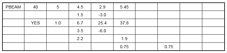

Example: Tapered beam with A = 4.5 at end A and A = 6.7 at end B.

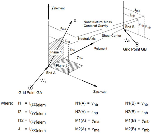

- Figure 1 shows the PBEAM element coordinate system.
Figure 1. PBEAM Element Coordinate System
