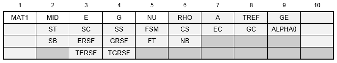

Isotropic Material Property Definition
Description: Defines the material properties for linear, temperature-independent, isotropic materials.
Format:
Example:
| Field | Definition | Type | Default | ||||||||||
| MID | Material identification number. | Integer > 0 | Required | ||||||||||
| E | Young's modulus. | Real ≥ 0.0 or blank | See Remarks 4, 5, and 6 | ||||||||||
| G | Shear modulus. | Real ≥ 0.0 or blank | |||||||||||
| NU | Poisson's ratio. | -1.0 < Real ≤ 0.5 or blank | |||||||||||
| RHO | Mass density. | Real or blank | 0.0 | ||||||||||
| A | Thermal expansion coefficient. | Real or blank | 0.0 | ||||||||||
| TREF | Reference temperature for the calculation of thermal loads. | Real or blank | 0.0 | ||||||||||
| GE | Structural element damping coefficient. See Remarks 10, 11, and 13. | Real or blank | 0.0 | ||||||||||
| ST, SC, SS | Allowable stresses in tension, compression, and shear, respectively. Required if composite element failure index is desired. | Real ≥ 0.0 or blank | 0.0 | ||||||||||
| FSM | Factor of safety calculation method, selected by one of the following values (see Remark 14).
Integer | 1 | ||||||||||
| CS | Honeycomb sandwich core cell size. Required if material defines the core of a honeycomb sandwich and dimpling stability index is desired (LAM = HCS on the PCOMP entry). | Real ≥ 0.0 or blank | 0.0 | ||||||||||
| EC | Honeycomb sandwich core Young's modulus used for stability index analysis. | Real ≥ 0.0 or blank | E | ||||||||||
| GC | Honeycomb sandwich core shear modulus used for stability index analysis. | Real ≥ 0.0 or blank | G | ||||||||||
| ALPHA0 | Fracture angle for uniaxial transverse compression in degrees. Used in the NASA LaRC02 failure theory only (see LARC02 in PCOMP entry). See Remark 15. | 0.0 ≤ Real ≤ 90.0 | 53.0 | ||||||||||
| SB | Allowable inter-laminar shear stress of the composite laminate bonding material (allowable interlaminar shear stress). See Remark 16. | Real ≥ 0.0 or blank | See Remark 16 | ||||||||||
| ERSF | Young's modulus reduction scale factor for nonlinear composite Progressive Ply Failure Analysis (PPFA). See Remark 18. | 0.0 ≤ Real ≤ 1.0 | 0.0 | ||||||||||
| GRSF | Shear modulus reduction scale factor for nonlinear composite Progressive Ply Failure Analysis (PPFA). See Remark 18. | 0.0 ≤ Real ≤ 1.0 | 0.0 | ||||||||||
| FT | Composite failure theory. The following theories are allowed:
Character or blank | |||||||||||
| NB | Allowable inter-laminar normal stress of the composite laminate bonding material (allowable interlaminar normal stress). See Remark 17. | Real ≥ 0.0 or blank | See Remark 17 | ||||||||||
| TERSF | Identification number of a TABLES1 or TABLEST entry which defines the extensional stress-strain relationship for nonlinear composite Progressive Ply Failure Analysis (PPFA). | Integer ≥ 0 or blank | |||||||||||
| TGRSF | Identification number of a TABLES1 or TABLEST entry which defines the shear stress-strain relationship for nonlinear composite Progressive Ply Failure Analysis (PPFA). | Integer ≥ 0 or blank |
